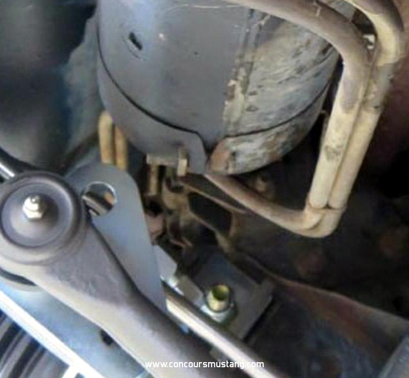

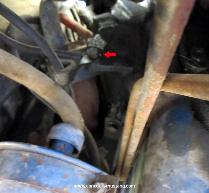

From the last 70 351C I was able to get under and get some pictures of. Of course was not focusing on the cable route just a couple of pictures that include some clues and details
From the front view it shows the guide attached much further forward than the motor mount like on other engine styles. - see red arrow
And from the rear the cable appears to be routed above the motor mount since it is not visible below in this shot

Believe that the pictures on the example suggest that the cable was only held to the engine/car with that single clamp like was done on some other V8's installed in the late 60's
If anyone is wondering about the odd bracket with the hole in it behind the tie rod. I think the car was being converted to some aftermarket steering system and that is one of the mounting brackets already installed
