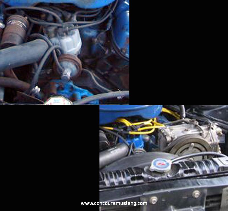

Looking through some of my pictures of 70 four speed Cleveland H codes found a couple of examples. Lots of AC cars that block the view plus not allot wwith manual transmissions

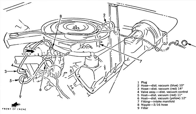

Also found this vacuum routing diagram that matches the two port advance

Thank you.  I have found diagrams for both hook ups of a dual and a single diaphragm.  I have found a few pictures showing a single but also dual.  I am leaning towards a dual setup.  On some things you might say either or would be correct but I really feel like this was not something Ford went back and forth on simply because of part availability month to month.  On the other hand I have found the 70 H code Cleveland's to truly be an oddity.

For 70 and other years  the type of transmission comes into play. Have plenty of singles but they are automatics equipped H codes ignored  those as well as those with replacement single diaphragm installed
We're you looking only at unrestored cars also?  Since that can provide allot of false findings when using a google picture search or similar tool.
Unfortunately Ford didn't label the two diagrams like they did earlier years. Best source would likely be the Electrical and Vacuum Manual but I don't own a 70 version
