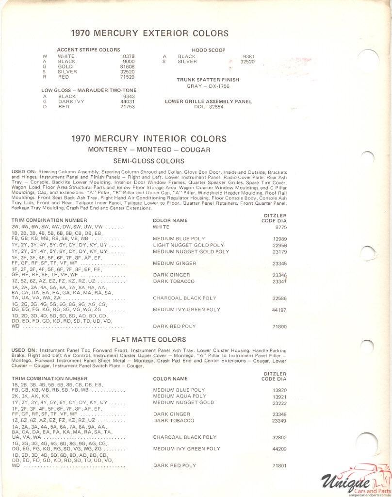

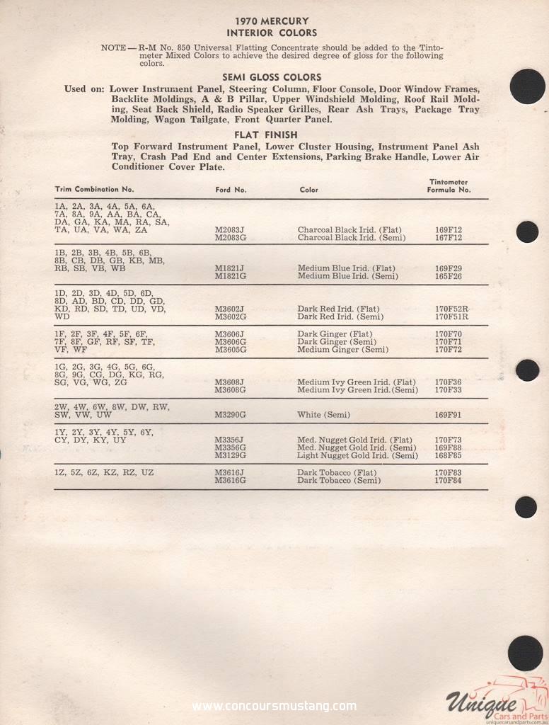

For 70 Cougar I have codes for "dark tobacco".
PPG 23347 is 20% gloss and 23349 is flat.  I also show R&M codes for them as well, 170F84, 170F83 but as Jeff said those codes are going to be tough to mix using today's components.  Best to find an original color part to use as a sample to have mixed.

Here's the stuff I've been finding and was hoping to use...

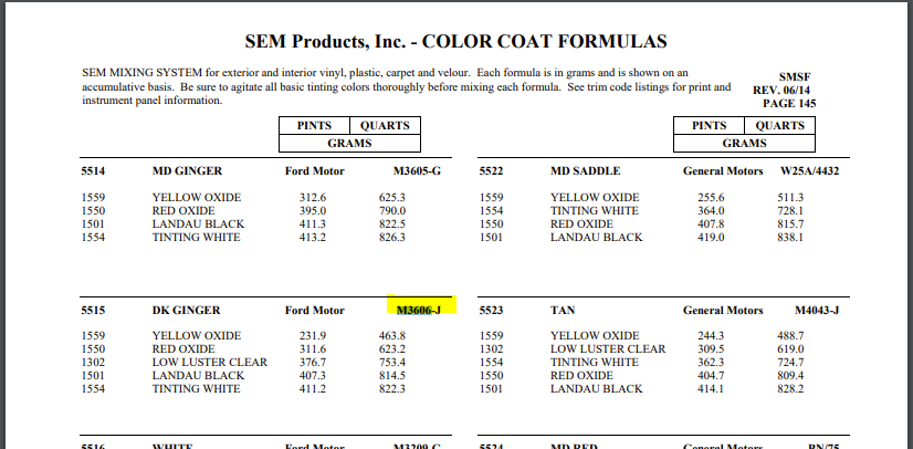

Guess your referring to wanting to use the SEMS product. Might want to see if its available in a rattle can so you can do a shoot out and compare. Would not expect it to match but we might be surprised though doubtful
