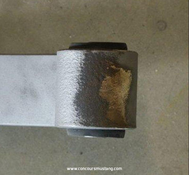

Here is a picture of the reminants of one such white mark found on a set of 69 Shelby rear springs. Of course it appears that what is left is maybe only 50% or less than the original size
Shown in the picture is the front spring eyelet. Have seen the white in another location on some examples but that was not apparently typical
