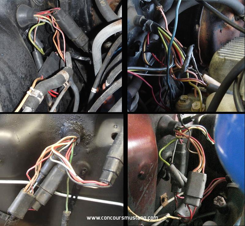

Looked through my pictures of 70's (both Boss and neutral) as well as 69 Shelby's and could not come up with a green female boot in any of my pictures connected to wires coming out of that lower center hole where the neutral safety and other plugs is grouped.
If its a really dark green boot guess the real dirty ones may look black but have some originals that are not dirty - have been cleaned.
Small sampling - Top two from 70 Boss 302's. Bottom twos 69/70 Shelby's

Black boot it is.  So...I thought Boss's didn't come with AC, yet you show examples of the AC wiring past the firewall.  I think that answers my basic question:apparently Ford used AC underdash harnesses (at times) for Boss cars, despite not using the integral AC wiring.
