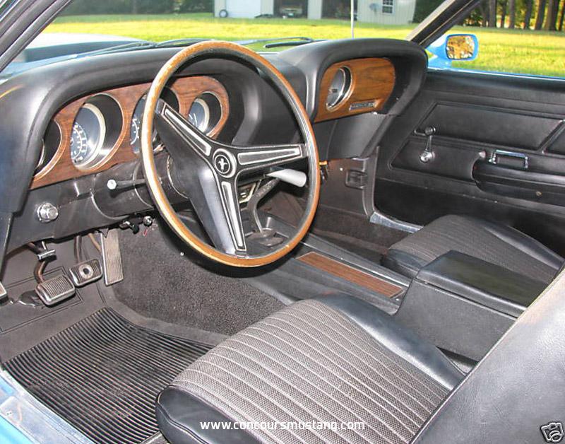

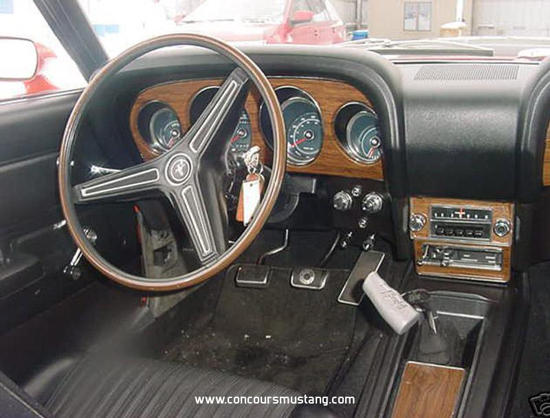

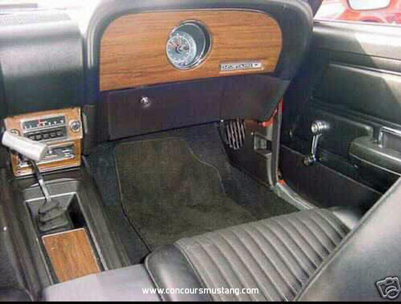

Only found a couple of examples with that 1970 interior code and the view is limited but hope they help in some way
Basically Standard door panels with the wood grain dash and seats that look like 69 Mach I but with a gray stripe
If I recall correctly the deluxe/Mach I steering wheel was a separate option that year

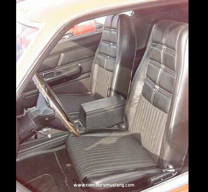

Hi Jeff, I found this on the Boss 302 site. I think this is what mine came with. Do you?

If you have the seats shown in the last pic you'll be met with sticker shock on the latest prices.
I'm still trying to figure out the button prices!

Going to make me do some more digging :)
According to what I see in examples that interior (as we see it) does not match what yours would have. Appears to be code EA which decodes as a black Delux interior  installed/available for 70 Boss 302 and 70  convertibles not sportroofs and coupes. This is one reason its been more of a challenge to find pictures of the TA interior
If we look at at some of the published descriptions of your interior they show "Deluxe " or "Decor" Interior and notes that these came with standard door panels as shown in the pictures I posted. If we expand outside of your specific interior codes and look at other color combinations under the same Deluxe/or Decor interiors we can find some other examples that can hopefully supply some details to help you.
Unfortunately the VIN tags made of vinyl attached to the doors often are difficult to make out after all these years so will also look for other confirmations of interior types this time through. Also sorry for some of the pictures. I'm often focused on other areas and details during the limited time I got with some of these cars.

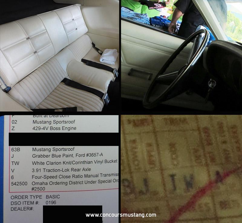

70 listed as being ordered with Delux Interior from one of the nicest unrestored Boss 429's in the country
Another very nice unrestored Boss 429 with a TW (White Delux) interior. Same option/family just different color

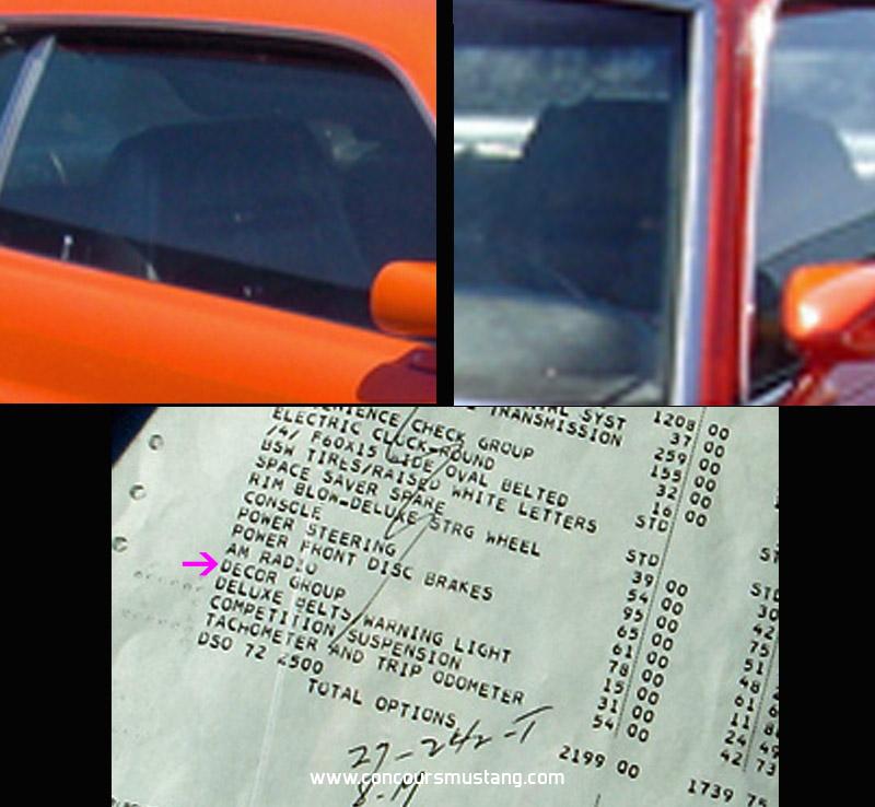

GTEDH as should be able to see I'm trying to be very measured and careful with my responses. The following is an example that may match your interior code (with the deluxe steering wheel option) but I don't know that the car has/had the same interior code but it looks like it might.
Hope all of these help

Thanks Jeff. The Marti Report indicates an Interior Code of TA.
So far it looks like the Boss interior.

Well is should in some areas and different in others based on what we have found so far. Boss is different and carries a different interior code.

Understood. The interior pics you sent me with the deluxe seats and the rimblow wheel and standard door panels matches.
