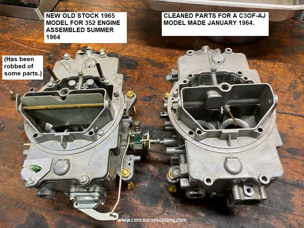

On the left below is a new old stock 1965 model year carburetor assembled in the summer of 1964. Ex-dealer stock somebody robbed it of parts long ago but it stayed very clean and all the factory paint and grease pencil markings are still present for parts still there. On the right below are a used body and cover for a C3OF-AJ carburetor I am working on for a friend. No, it is not possible to get just out of the mold appearances for old used aluminum parts but if no one has damaged them and they do not have corrosion from something like antifreeze/coolant they usually clean up pretty well.
The C4OF-AT carburetor below is not what I call a restoration. Cleaning removed all factory paint daubs and grease pencil marks so I did try to recreate all of them accurately. (The owner supplied the freshly replated air cleaner stud shown.)  I cleaned and serviced it for an old friend. The worst stain it has is a dark line across the choke plate from antifreeze/coolant corrosion.
My process set is a long one. I spent 9+ hours masking, cleaning, dealing with gasket flange burrs somebody created before I got it, testing all the threaded holes, testing relative flows through all calibrated orifices, and gently chemically cleaning all the brass orifices and tube bores the body and cover for the C3OF-AJ carburetor above.  (It is best to never run metal anything through calibrated fuel and air passages. The tiniest scratches or burrs can seriously affect in use air and fuel flows. Holley Carburetor Company use to give a document to racers that mentioned what their research results on damaged orifices were. I inspect every calibrated orifice under a very well lighted binocular microscope. Any removable orifices with any scratches or burrs go into the trash. Limited repairs can be made to orifices that do not come out or out easily. Vacuum pickup tubes in 4100 cover assemblies often need some amount of repair and often correction of angles and position relative to the auxiliary venturi to get in the factory specification location.)

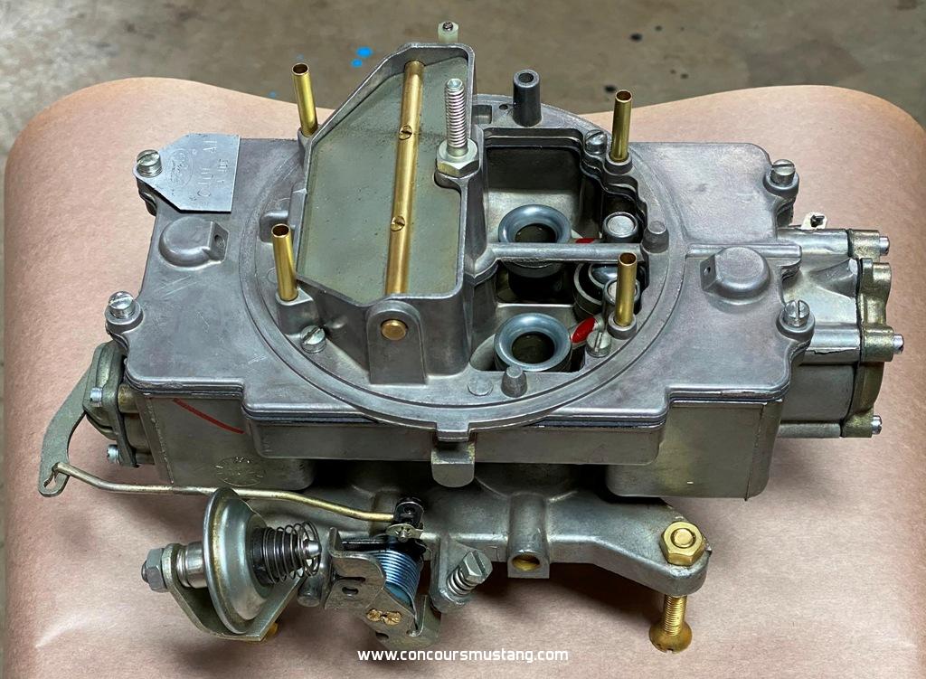

Back to the original program, I just wanted to share what has worked on Ford 4100 carburetors for me for years.  Holley(R) carburetor parts made of die cast zinc can be medium pressure walnut media blasted to clean the foreign materials layer off. If the parent zinc and dichromate conversion coating are in acceptable condition underneath the crud they normally come out looking good enough for anything but serious show car duty.
I am not suggesting that anybody has to follow my processes. Just sharing. I always try to preserve the original surfaces and finishes first  and have done so since 1961. That is not always possible.
During 2011 I cleaned up and serviced the induction system for a CSX31xx series 427 Cobra. The induction system was removed from the original engine in 1968 and placed on a shelf in a commercial shop. Circa 2005 it was rescued by the current owner of the car. It was a mess as it was covered with a heavy layer of shop grime and paint over spray dots. The owner wanted me to clean and service it to ready to use condition. He wanted no restoration.
One of the carburetors before and after my cleaning processes.
The fully cleaned and serviced system. WD40(R) soaking two weeks, medium pressure walnut shell blasting, and the intake manifold got a final rinse with lacquer thinner out in the field behind the shop using a body paint spray gun from the 1960s. No parts were replated. No glass bead blasting. The heater shutoff valve is a new old stock one I found. The oil fill tube was badly banged up so I repaired it. The owner wanted it left bare steel until he painted the other engine parts at the same time so I did not paint the tube. The MS nuts and AN base fixing washers are new made reproductions of the 1960s versions of parts SA used. It came out okay I think and the owner loved the job I did.
