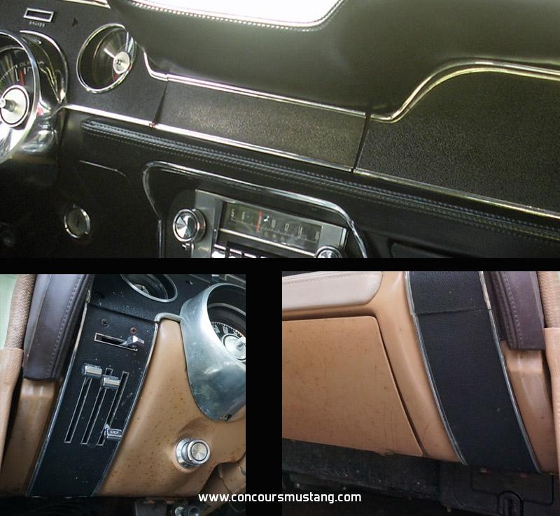

  Thanks for all replies, nothing wrong with dash panel, if removing the heater and air control with register below, would replacing with heater control only cover opening in dash panel? Ordered all Jim Osborn assembly manuals.
  • Posts: 24864
Re: dash panel difference
« Reply #5 on: April 14, 2022, 08:28:57 PM »
  Thanks for all replies, nothing wrong with dash panel, if removing the heater and air control with register below, would replacing with heater control only cover opening in dash panel? ..................
These pictures help? :)  Non AC 67 dash details
