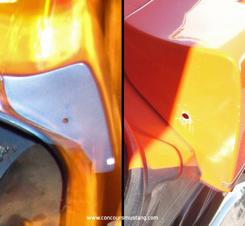

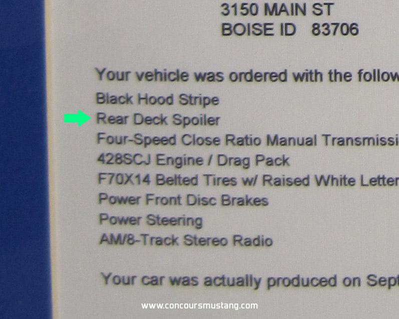

Yes as shown below
Original 70's are much easier to find since they were optional on allot more cars than in 69

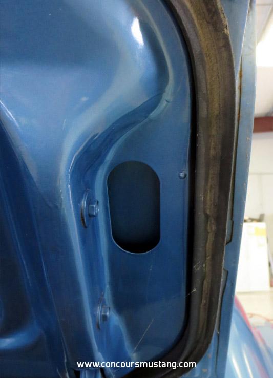

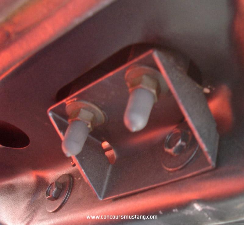

Respectfully disagree. 70 trunk lids for sportroofs/Mach I all had the provision to save cost and inventory hassles as shown below from a Mach I that is in the Unrestored picture thread sections of the site. Do have more examples
For the other part of securing the spoiler bracket to the car it used the outer trunk hinge bolt location as shown below

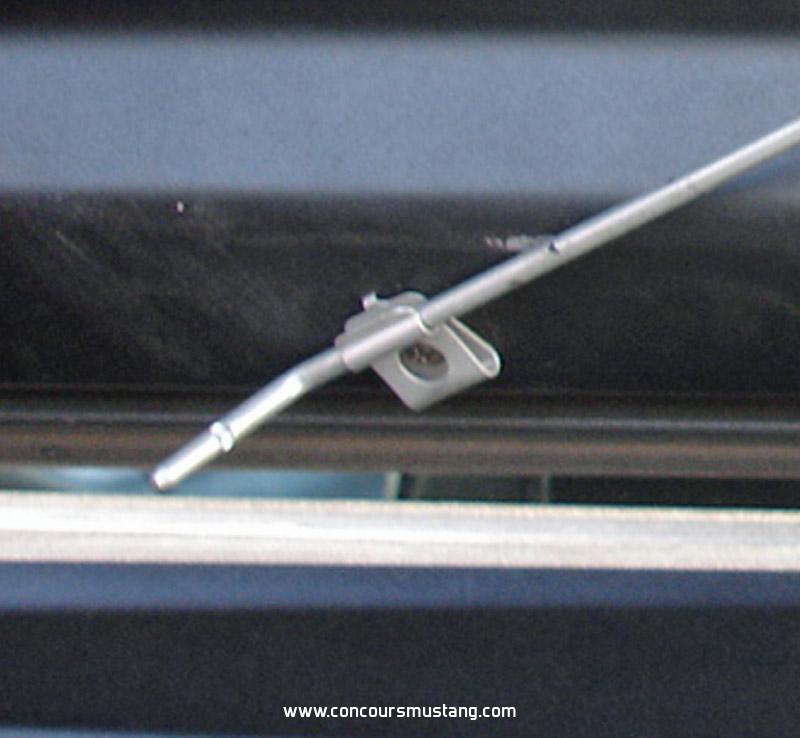

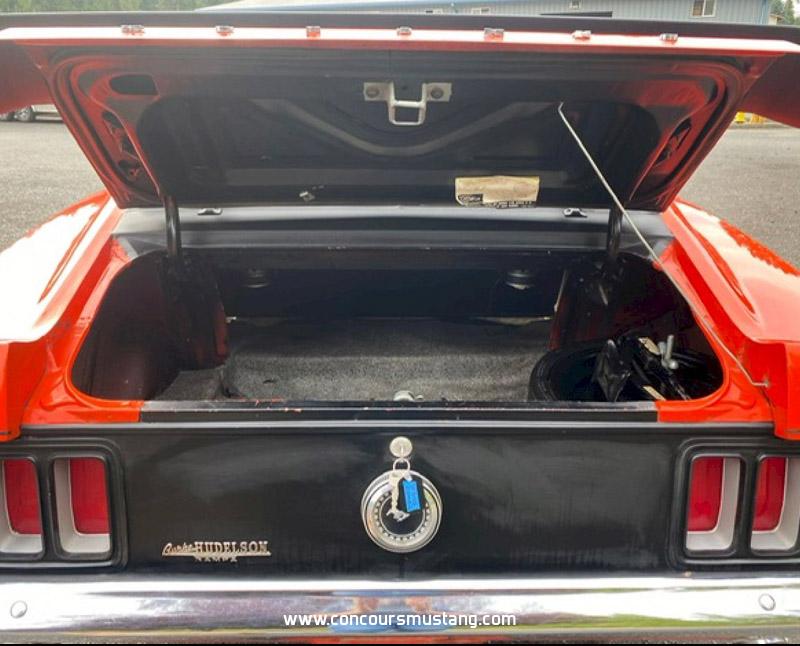

« Reply #5 on: April 23, 2022, 12:40:03 AM »
All Peddals and gaskets are factory. And will I need a support Rod? Any Photos how to install?
Here you go. Sources are from 70 Dearborn examples
Overall from a Boss 302
Hole for rod in passenger side end cap
Close-up of the retaining clip for the rod
Hope these help you and others
I stand corrected it was the 69 lid that did not have holes all 70s do.
