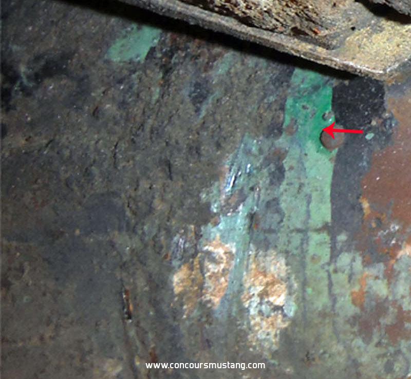

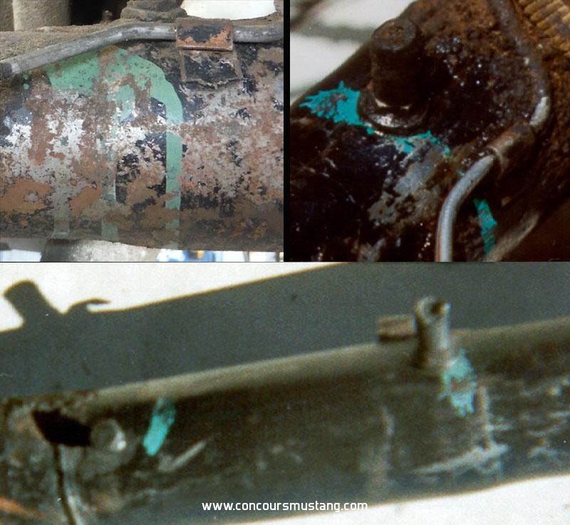

So this is on top of the housing on the drivers side.
Like most color markings/daubs they were applied to speed up the process of building and assembling the car or subassemblies like rearends at the Sterling Plant
Color often varied. In the examples below the color appears to be lighter hunter green to teal to a brighter strong blue. The color used does not relate to the application.
As you can see that on housings with the brake junction/distribution block and a separate vent they applied two such marks where on others with a single hole they applied only one

Thank you Jeff, I was on the right track, I have a few pics I took on tear down but a very small sample. Kinda of a light teal and it ran to the bottom of the housing. Thanks again.  Greg  Seattle
