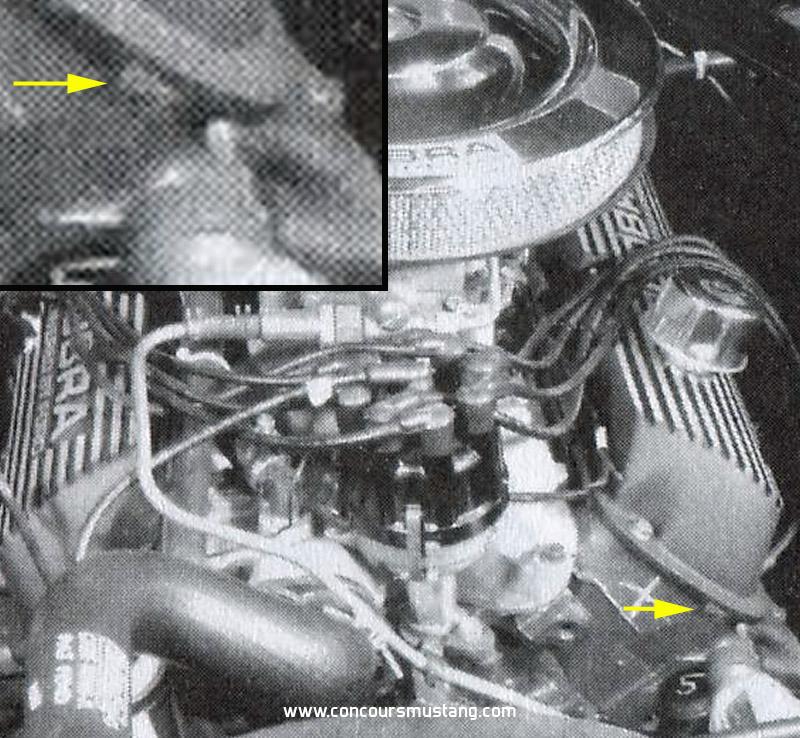

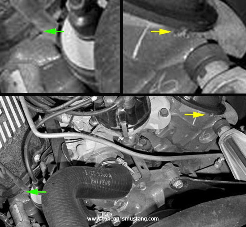

Here are some pictures from magazine articles printed in 66-67 showing 67 GT350's engines and the valve cover gasket tabs Believe picture #1 and #2 are the same car from different angles and possibly different articles. Top and bottom side tabs are difficult to find in magazine shots  :(

Great pics to back up the black gasket.
Other than the carb base gasket this is all really well defined. I appreciate all of the help and I'm sure others do too. The list at the top contains the latest data.

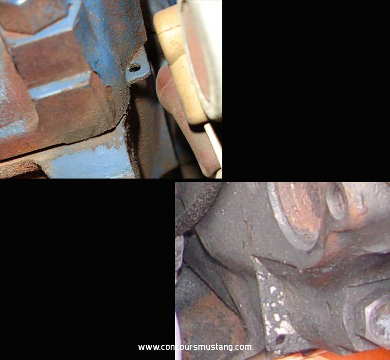

While searching for a head gasket with front extension and hole, I came across a possible reason for this design.
The Felpro 9333-PT-1 head gasket is the recommended head gasket by FRPP for early cars (In the M-6003-A50 kit). In the instructions is the attached note (see pic).
It appears this would be a quick and easy way for an inspector (and you!) to see that the head gasket is installed correctly. It's also a gasket that replicates the early style in this regard and all I have to do is modify it a bit.
I'll order a pair and see if I can modify it to be a bit squarer and see if it drills nicely.

I order a set of FelPro 9333 PT-1 head gaskets and I placed it on a 289 block along with a spare head (yeah, it's dirty).
Here is Jeff's  pic:
And attached is a pic of that gasket mocked up on an engine.
Just use a punch to make a hole and I think it works.
