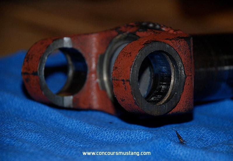

I dropped the yoke in fresh Evaporust and it came out perfect!   You can clearly see the original orange paint.
The paint is a dull flat orange.  The pics I have seen on here is a bright orange.  Has the original paint faded, did the Evaporust change the color, or do I need to match the color I found?  (In the pic it looks much brighter than in person)
Yes the original color has likely been altered by time and exposure. Here is an example of a cleaned original we have posted by a member in another thread.
It may be currently flatter (not glossy) due to the chemicals, exposure, age and so on compared to the original finish and yes of course colors look different after being taken with a camera and then posted and viewed on a monitor
