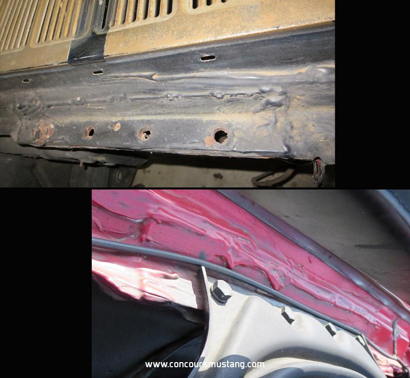

Though its not the export brace a good discussion of the 65-66 export braces would not really be complete without the description and a few pictures of the support brace that was welded to the cowl lip in the engine compartment where the center of the export brace was bolted to. Apparently the engineers figured out that they wanted a thicker and stronger section of the body to body the export brace to and had the plate below added to those cars ordered with the export package on 65-66 examples.
Brace was welded and heavily chalked with sealer producing what many describe as a mess job

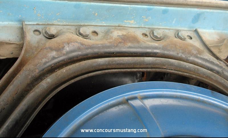

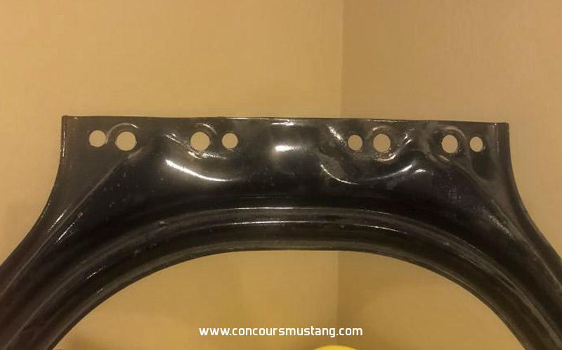

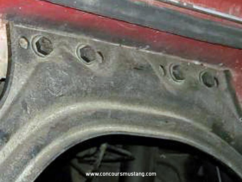

Over time an oddity has shown up in a small number of vehicles built during 1967 production where it appears the early evenly spaced export braces were re-drilled and used on the assembly line. No pattern has been established yet but I offer the following examples so we can keep an eye open for additional examples. Must note that equally spaced export braces in the service replacement supply change did not last long as were quick;y replaced with the newer version that did not require re-drilling of the cowl/firewall. Interesting that all three examples are from an approx six week period.
Example from a San Jose built car completed Mar 23, 1967. A Shelby since few export Mustangs were built at San Jose
Example from a New Jersey built car completed April 4, 1967. 6 cylinder export car. Only have the projected build date of May one
Example from a New Jersey built car completed April 4, 1967. One owner export V8. Is in the unrestored picture thread section
