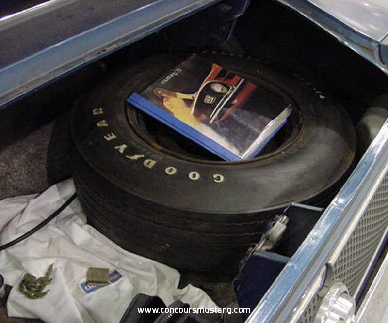

From the picture it does not look like the full size spare is positioned correctly. You may get a idea for location by look at jacking instruction illustration . The center hole of the steel wheel should be fairly centered over the trunk floor welded on loop for J hook .

Would someone look at my trunk pic and tell me if something is amiss.  My spare tire F70x14 on a 6 1/2 inch steel wheel will NOT align up with the J hook and centerhole of the Ford OEM steel wheel.
Does anything look like it?s been messed with or changed, is the taillight housing incorrect or what.
I?ve tried and tried but the J hook is at a extreme angle, sideways.
I posted pics of the spare tire on my first posting, if you need to see the spare tire in the trunk.

Comparing to other examples and looking at the pictures you posted it appears that your car has not had its trunk floor replaced on the passenger side so the bracket and the bracket location appear to be as designed.
Given that you provided the size of the rim  14 x 6 1/2 were left with the out side diameter of the current tire you have mounted is greater than the original tires was.
