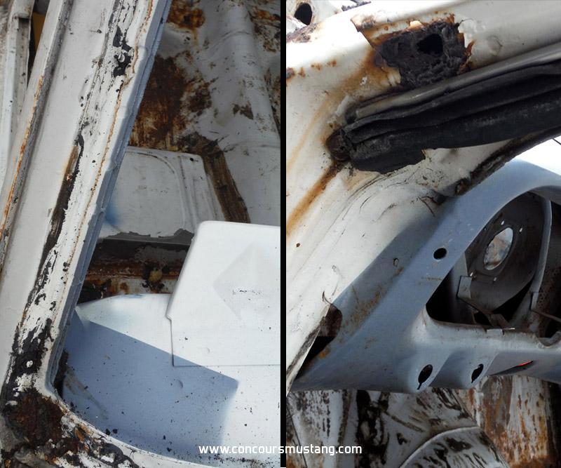

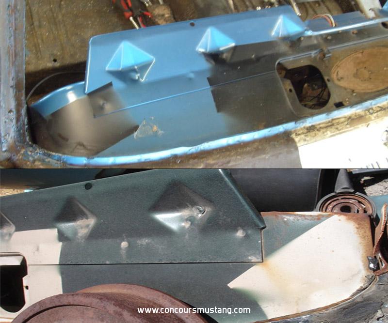

Since the interior color was applied first (example inside of the door, main dash area and A pillars) that area was masked off to protect it from the exterior color was applied. The top of the dash was not typically protected from the exterior paint and that is why your seeing both interior and exterior paint on the top of the dash. Since both interior colors are similar I've posted a picture of a car with contrasting colors/paint to illustrate. Have a fair number of others but this should do it.
Example #1 - Blue interior and white exterior
Example #2 (top) - Black interior and blue exterior
Example #3 (lower) - Parchment interior and dark green exterior
