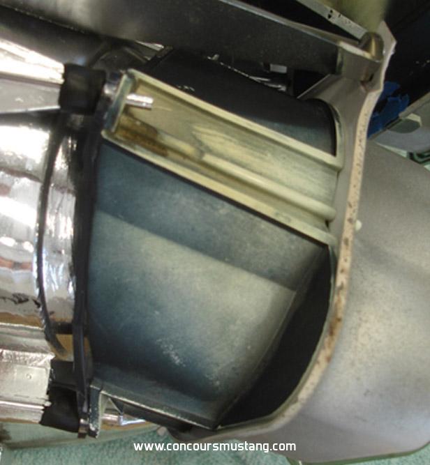

Most just use a egg shell or sightly less black for this purpose. Originally it did have a blue tint when sprayed thin (like the factory hood black out used in 69) that built to black with more paint.
Similar question and answer in the thread below
https://www.concoursmustang.com/forum/index.php?topic=2159.msg10941#msg10941
Just happen to have a picture showing the effect and the look when shot very thin. In this case overspray from the inside application. Guessing this is what you've seen also

I see the black overspray on the back of my bezels to.  However, the inside of all the bezels are a drastically different color.  It has a blue hue to it.  Am I missing something or does the black on the inside of the bezels turn blue over 50 years' worth of gauge lighting and fading or is it actually a different color?  I want to paint them as you can see they are splotchy, but I don't want to find out after re-assembly that I got it wrong.
