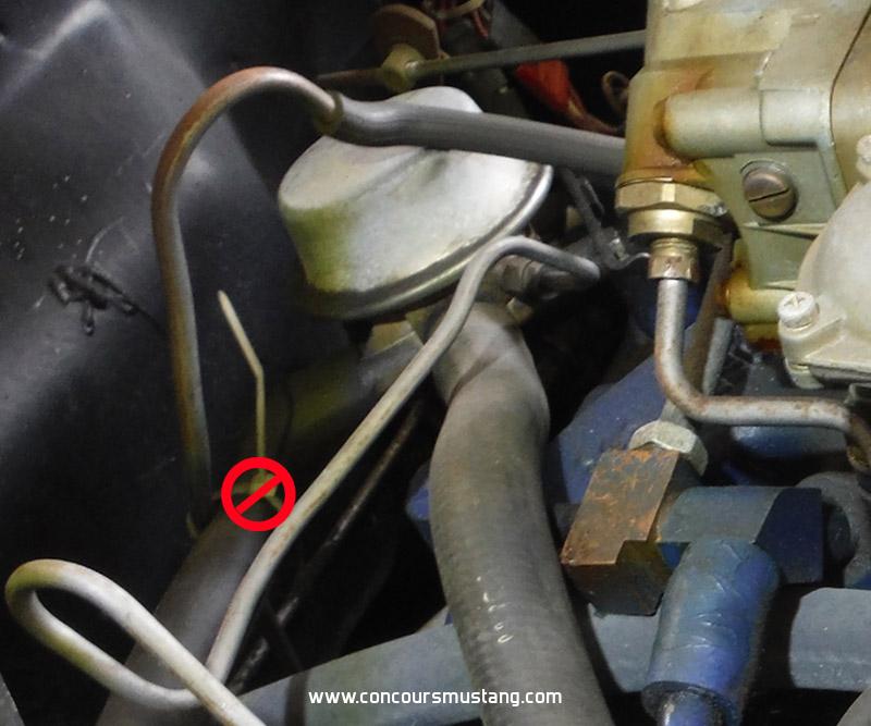

I do not believe the brake booster supply line is originally painted Corporate Blue
« Last Edit: April 28, 2023, 05:25:15 PM by J_Speegle »
Re: S code Intake Manifold Vacuum Tree
« Reply #6 on: April 28, 2023, 05:21:28 PM »

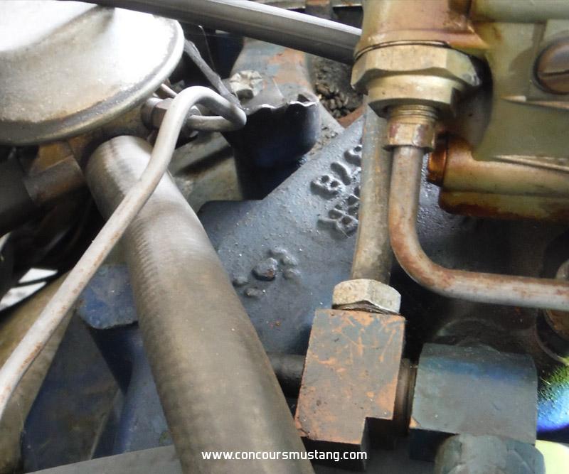

+1 The block it was attached to was not installed when the engine was painted so no way of it being attached
Looking at this example (7R02S2072xxx a non AC car) the rear vacuum block appears to not be used except for the power brake booster and the nipple/nipples are just caped off. Note - yes there appears to be a little blue paint overspray from some touch up the owner did somewhere in the area but we can, with ease, see the difference from the heavy paint application to the right on the base vacuum block and other items on the block and the light overspray
Only source that is not accounted for that I can think of for your application would be for the vacuum canister for the AC
https://www.concoursmustang.com/forum/index.php?topic=9931.0
Unfortunately don't have one of those oversized Electrical and Vacuum Diagram books for 67
Did find a few scans from the manual posted by a member in another thread but unless I missed one they are from the interior side though show that two lines go to the engine compartment One to the vacuum canister which would have gotten its vacuum from the engine
https://www.concoursmustang.com/forum/index.php?topic=13603.msg84323#msg84323

Not the ones you showed in the picture in your initial post. Borrowed from a different application. The brass one if it has the large threaded hole on the end we can't see may have been used originally since I've seen both three and two nipple used though capped off if not used

+1 on the painted steel vacuum line. Also the additional vacuum port for the automatic transmission can be seen at the back of the carb spacer in the 3rd picture.
