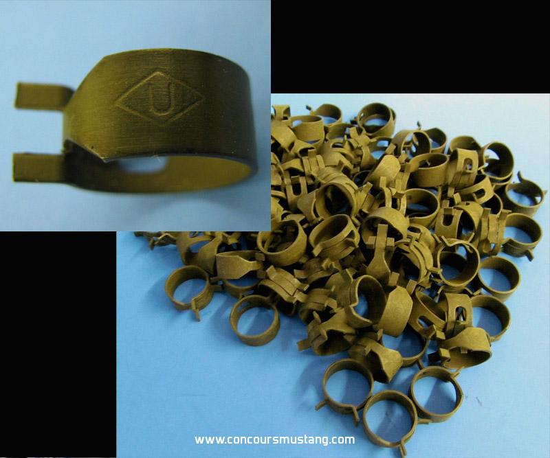

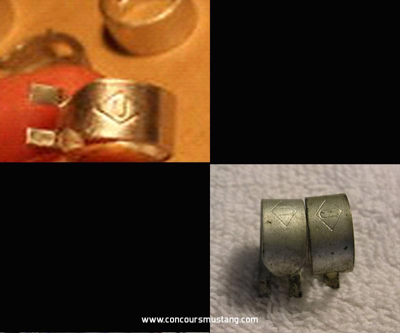

As for the Diamond/U marking here are a few examples
And for others seeing the thread the finish change after 67 for most of these as used on our cars
