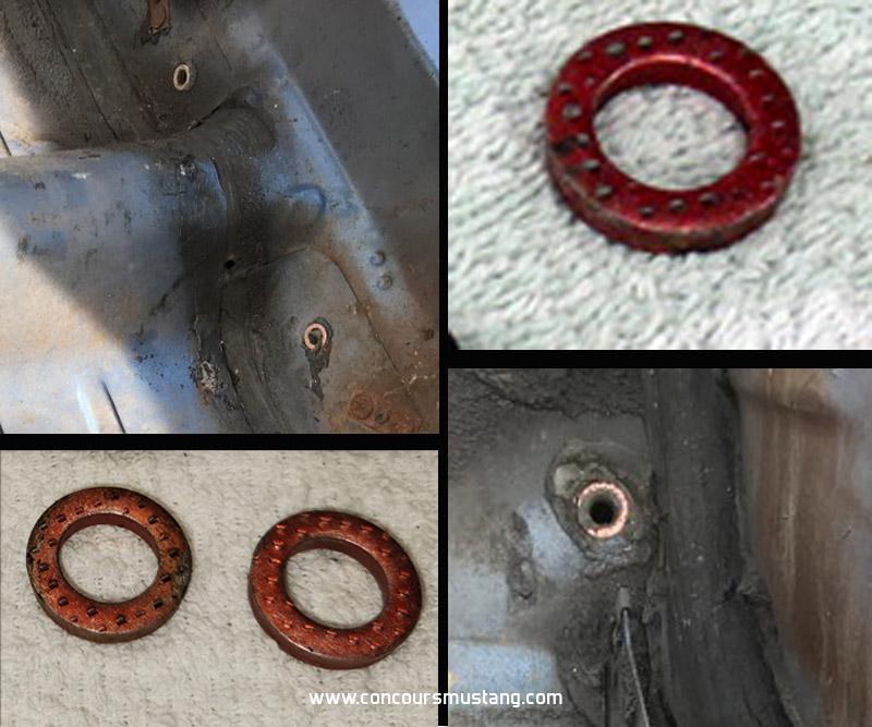

Seat belt base washers though unseen were red dyed in 68. Don't know when that was started
Examples from in the car are from 8R1718xx so fairly late car. Individual washer in the close up have not been restored

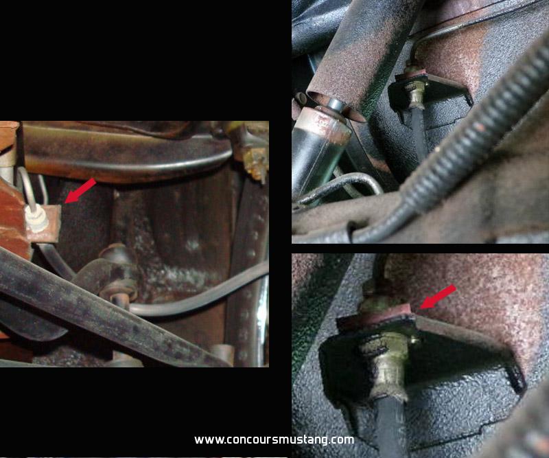

Then we have the solid brake line to flex line retainers. The U shaped clips that slide into the end fittings. Finish is typically a chalky red dye finish
For drum brake cars there appears to be 3 of them One at each front brake line and 1 at the rear.  For disc brake cars a single one from my recall

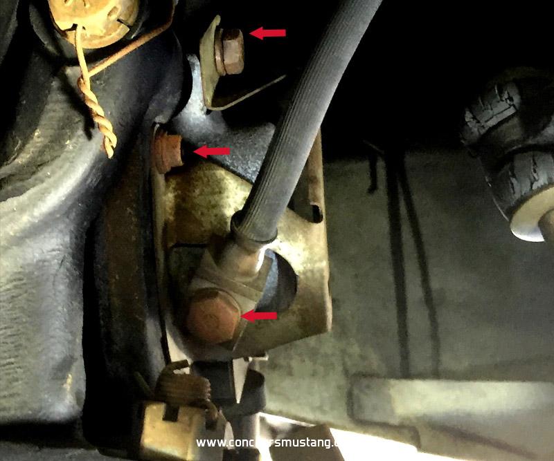

Possible support/evidence of three caliper related red dye pieces of hardware
Don't recall for certain, right this moment, but another possible unseen (once the car is completed) red dye candidate might be the bucket set mounting nuts and cage washer. Will let others confirm rather than removing one from a car right now.
Yes my seat belt hardware looked just like that as well
This is new to me I did not have those on my list
On another possibility have not found the fastback rear seats rear seat upper panel for non-fold downs red dyed on examples I've found.
I got 2 out of three, but not the shield bolts
