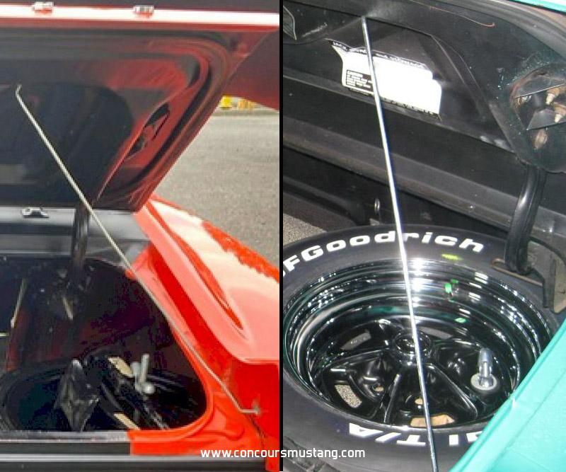

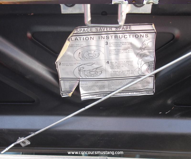

First lets look to see what we have as far as original examples from Dearborn for 1970 production year. To me it appears to have been cad or a dull zinc. Best guess IMHO cad
0F125xxx and 0F126xxx
0F151xxx
0F194xxx

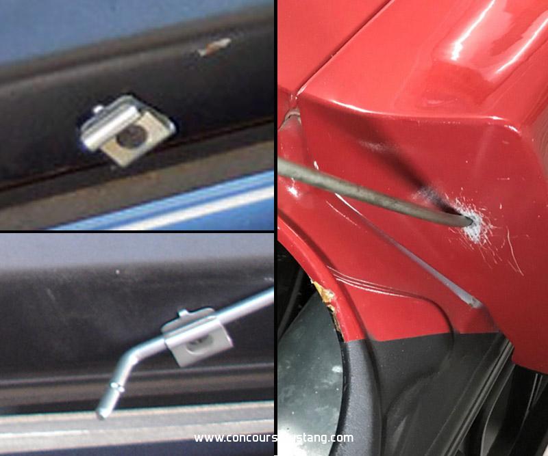

Clip and end cap hole for end of prop rod. Well used with some plating damage and surface rust  ::)
For those comparing the clips and the hole are in different locations than we see in the Metuchen examples from 1970 production in the other thread
