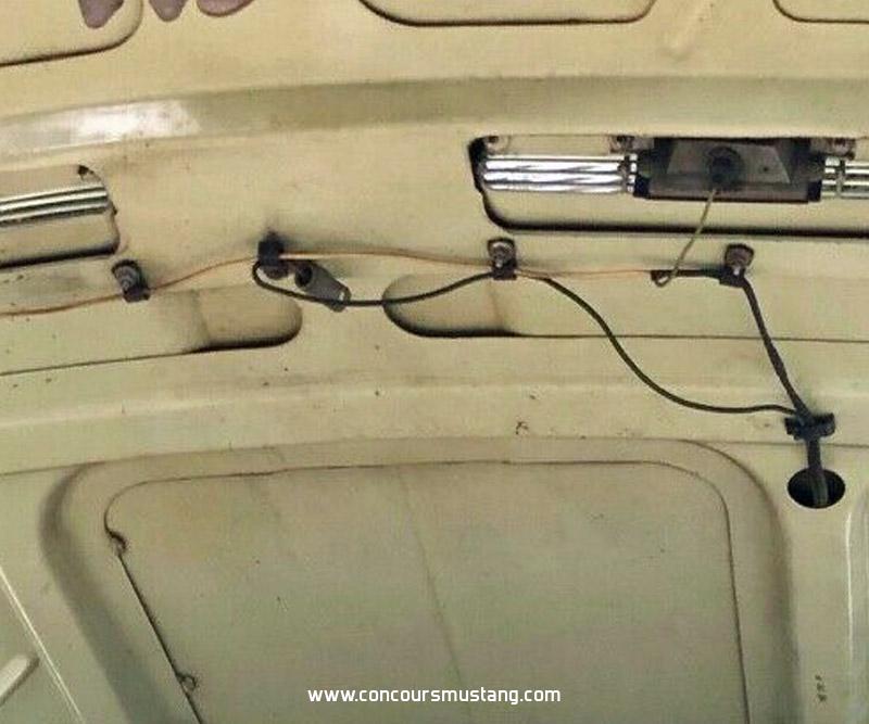

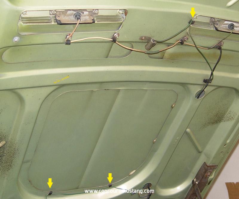

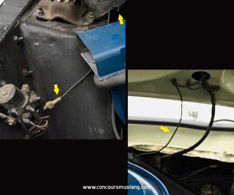

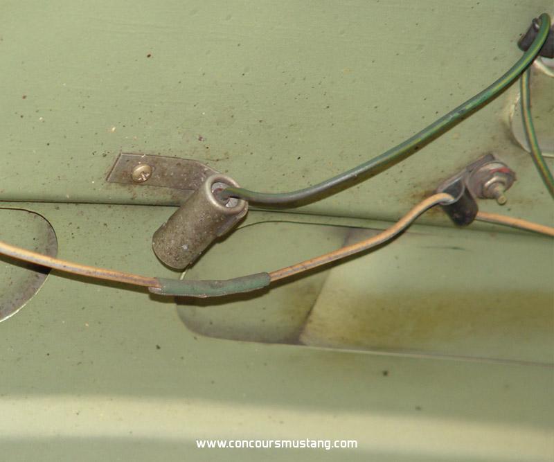

Looking at these and the San Jose examples in a separate thread there was a single wire that ran from the light mounded in the center of the hood that traveled down to the bottom (once hood was open) where it exited and was retained with a small plastic retainer. It then traveled under the cowl to firewall pinch weld/lip to the solenoid where there was a inline fuse holder made of white or off white plastic. There are a number of those small thin sheetmetal retainers located in different spots or locations. These retainers of clips look to be the same that were used on 65-66 fastbacks in the trunk holding the wire for the passenger side rear interior light as it traveled across the trunk just below the rear window.  Maybe different workers choose different spots when they did it. The wire and in some cases the clip is highlighted in some pictures with yellow arrows.

8T02J122xxx No clips at this end of the hood though guess one or more might have fallen off - or just never used
Other end of the hood and at solenoid
8T01J199xxx With one clip at the top of the hood when opened and two oddly at the bottom of the hood.
Closer look
