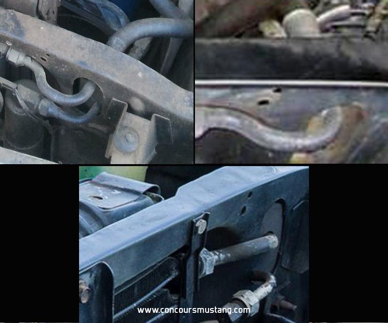

« Reply #4 on: November 19, 2023, 04:25:51 PM »
+3 :)  AT least confirmed for San Jose built examples such as the ones below. Just happened to have collected these in a separate file so they were handy. Examples spread from 7R110xxx-7R1977xx so they reflect most of the production period. Have not see adhesive used to hold them in place not the remains of such except for one 1970 Dearborn and it was a yellow colored product applied to the forward face of the radiator support. Finding only one example out of maybe a thousand or more suggests IMHO at this point it may have been added post delivery
« Last Edit: November 19, 2023, 04:58:05 PM by J_Speegle »
Re: 67 AC radiator support grommet installation
« Reply #5 on: November 19, 2023, 04:43:46 PM »
Did a quick look through my 67 Dearborn pictures and there were a few examples where the gasket was still in place. From this very small sample it is possible that Dearborn workers assigned to this task may have followed the recommended side of the radiator support more than San Jose did. As you can see in the picture below they were all positioned from the engine side
« Reply #8 on: December 01, 2023, 03:18:21 PM »
Not a support grommet observation but a A/C one. The bracket that is used to hold the two tubes running through the radiator support are typically zinc Phosphate including the fastener and not painted black.
We're going to have to agree to disagree on this point in a respectful way  :). Have found a fair number of them painted black as shown in the lower right picture, painted black while allot of them I've seen were not or simply rusty on 67 San Jose cars.
« Reply #10 on: December 01, 2023, 05:06:01 PM »
On the topic of black or blackout, what about the line set.  I think I've seen enough pictures where the parts exposed in front of the radiator support are painted black.  I'm wondering what the line of demarcation is heading towards the engine.  Are they painted all the way to where they transition to rubber or does the paint stop before that?
« Reply #11 on: December 01, 2023, 06:45:34 PM »
Well the ones I have seen on 67 that were zinc phosphate that were in a surviver context may be as a result of late in production .The ones I have seen on 68-up versions were zinc phosphate which is why I said "typically" meant taken as a whole . At the very least I have a high confidence level that not ALL of 67 ones were painted black.
« Reply #12 on: December 01, 2023, 06:53:41 PM »
I don't believe they were consistently all painted black based on observations of a number of originals over the years. The ones that were painted black appeared to be sprayed black from the front side to black them out . I haven't seen signs of a paint brush used given the ones that I have observed had a feathered transition line instead of what looked like brush strokes . I would not be surprised however if they were paint brushed also . In fact the paint brush method would seem to be the logical choice . I just haven't seen those .
« Reply #13 on: December 01, 2023, 07:09:02 PM »
I don't believe they were consistently all painted black based on observations of a number of originals over the years. The ones that were painted black appeared to be sprayed black from the front side to black them out . .................
Also likely that often this can be the result of a used car freshening we often see. If you find one with lines blacked out at the front of the radiator support check to see if things like the spring cover bolts are black also  ::) Just a place to start the investigation
