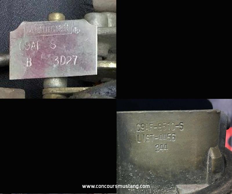

Hello Bob,
Thanks for replying to my post. I have another question regarding the Autolite tag. This tag has C9AFU stamped on it. Now will the choke air horn have the same thing stamped on it just like this tag? Or just C9AF? This is what is stamped on the choke air horn C9AF-9510-S
Sorry for not getting to to this post earlier

Hello Bob,
Ron, the air horn will have the C9AF 9510 U  with a date code underneath. I hope this helps.

« Reply #20 on: January 17, 2025, 09:41:19 PM »
................. I have another question regarding the Autolite tag. This tag has C9AFU stamped on it. Now will the choke air horn have the same thing stamped on it just like this tag? Or just C9AF? This is what is stamped on the choke air horn C9AF-9510-S

« Reply #21 on: January 17, 2025, 09:43:48 PM »
 To add if the carb air horn is stamped C9AF 9510-S then it is a much harder to find and valuable Boss 429 carb.

« Reply #22 on: January 17, 2025, 10:46:50 PM »
Was going to mention that but couldn't figure the best wording so left it up to you  :)

« Reply #23 on: January 25, 2025, 08:05:05 PM »
Bob,
Thanks again for the information. This is the carb that I'm asking about. it was fully restored and live run-tested by Vintage Musclecar Parts.

« Reply #24 on: January 25, 2025, 08:27:57 PM »
Bob,
It appears close to fully restored only because I see somethings that they left off and some incorrect finishes but It looks very good over all. Best of luck in whatever the end purpose is.

« Reply #25 on: January 25, 2025, 08:42:14 PM »
So, what is not correct and what is missing?

« Reply #26 on: January 25, 2025, 11:37:29 PM »
Thanks again
The plastic metering screw covers are missing. Many carb restorers plate everything gold zinc when some things should be silver zinc. The things that I notice that I can tell from the picture which should be silver and not gold are the - short accelerator pump lever,dashpot screw,vent lever hold down screw, needle and seat lock screw. There may be other things that can't be seen in the pictures. Those are all somewhat easy things to fix . I hope this helps
