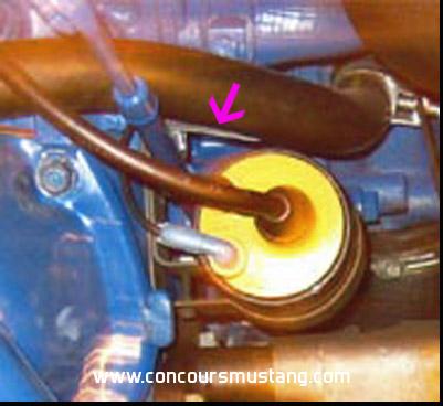

Where and how is 1969 351W engine tag mounted to the engine? I have a late 69 351W 2V  PS/PB/AC. Any pictures?

Attached to the engine with the same bolt that hols the dip stick tube and coil bracket

So besides using the "dip/distributor" bolt, what is the placement of the tag? Is it up/down and was it originally bent at the factory in a particular way?
Re: Engine Tag- 69 H Code Location
« Reply #6 on: March 05, 2024, 03:18:54 PM »
I have seen them up or down . Up is probably more readable not bent in a particular way . If you are concerned about this nuance issue you may want to update the finish on bolts in the picture that would be at least as noticable if not more. The hold down bolt typically S7 zinc silver and intake bolts would be painted engine color along with the intake gaskets.Thermostat housing would be painted engine color. There are other things too.
