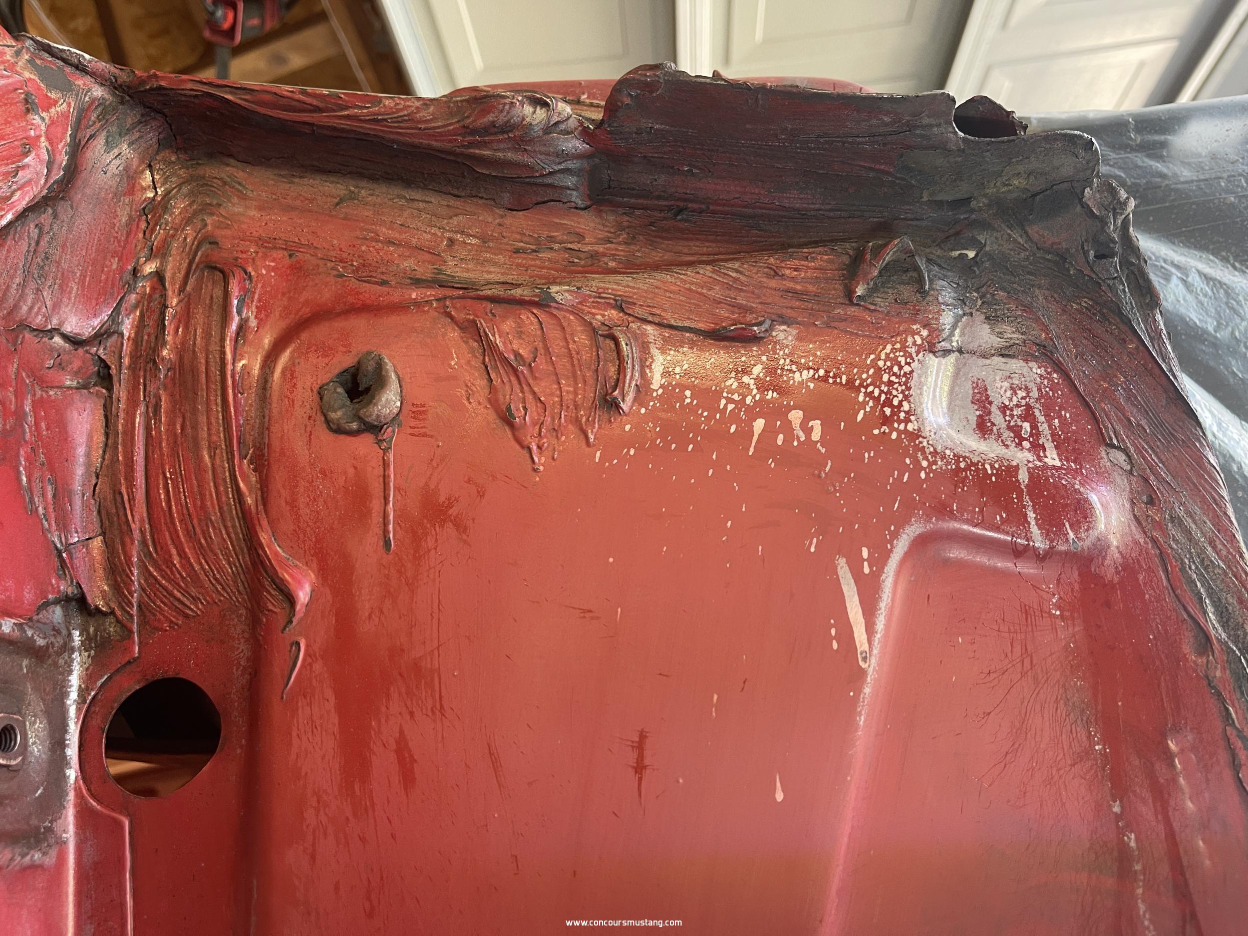

Can Old Body Sealer Be Cleaned Up And Painted Over?
« on: July 06, 2024, 01:00:22 PM »
Lots of info on removing, applying new body sealer, duplicating factory look, etc.
But can old sealer be cleaned of the dirt and grime, coated with epoxy 2K, and repainted?
Mineral Spirits and soft toothbrush seem to clean pretty good.  Some touchup will be needed.
Just wondering if anyone has tried it, and the results, good or bad.
Thanks, Ken

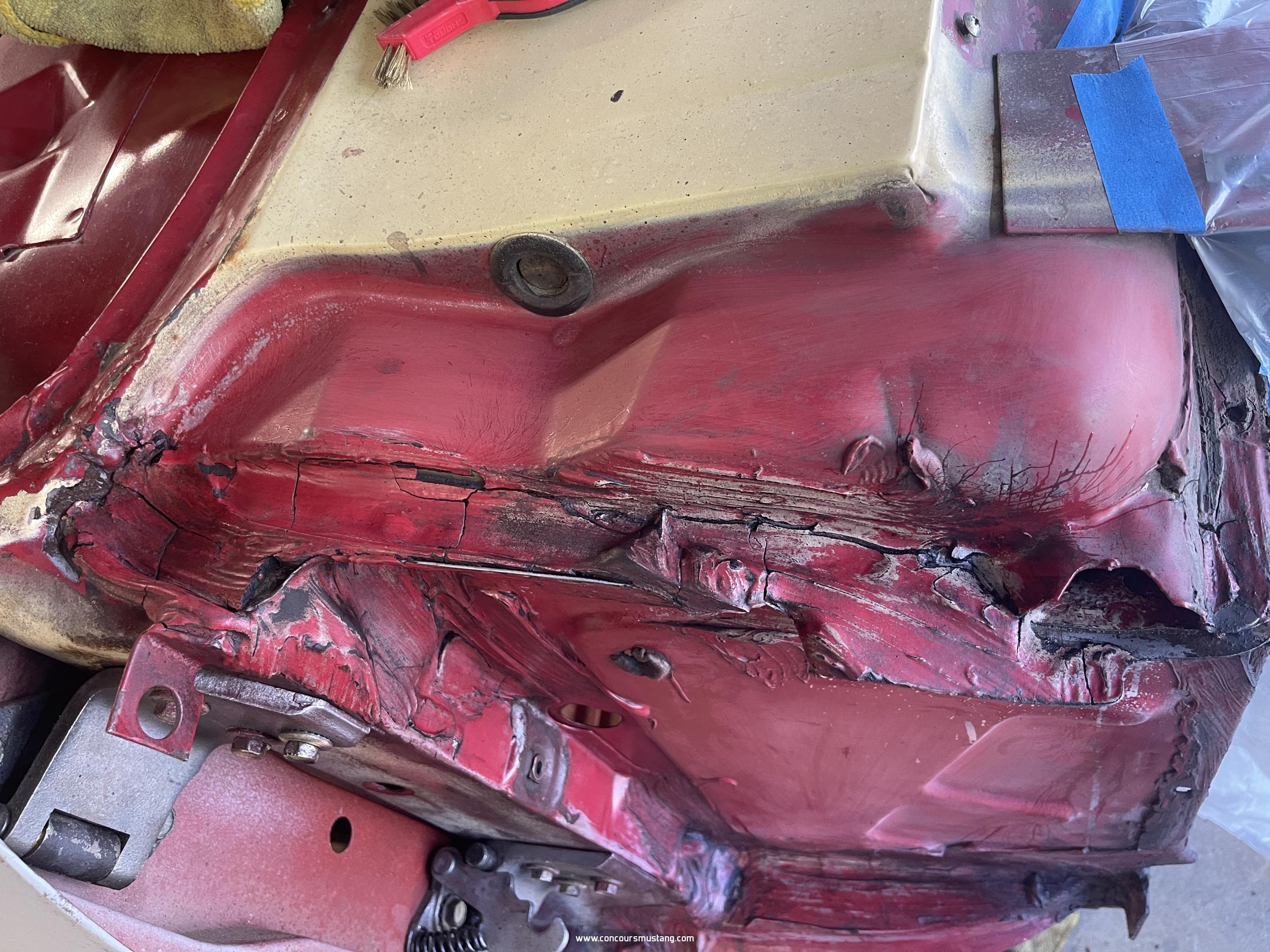

I found that acetone worked well cleaning up the old black gunk off the body sealer with scuff pad.  Wished acetone didn't dry so fast, had to work on small areas fast.  Knocked off any loose sealer, cleaned cracks with a brush.  Treated any exposed metal with inhibitor.  Applied brush-on body sealer with gloved finger, thin coat, just enough to cover, filled in cracks and replaced missing areas.  Doesn't look exactly like the old brush marks, but good enough. Maybe should have used cut-down stiff brush instead.  Epoxy primer is next after some more metal prep and removing doors.  Trunk is next.

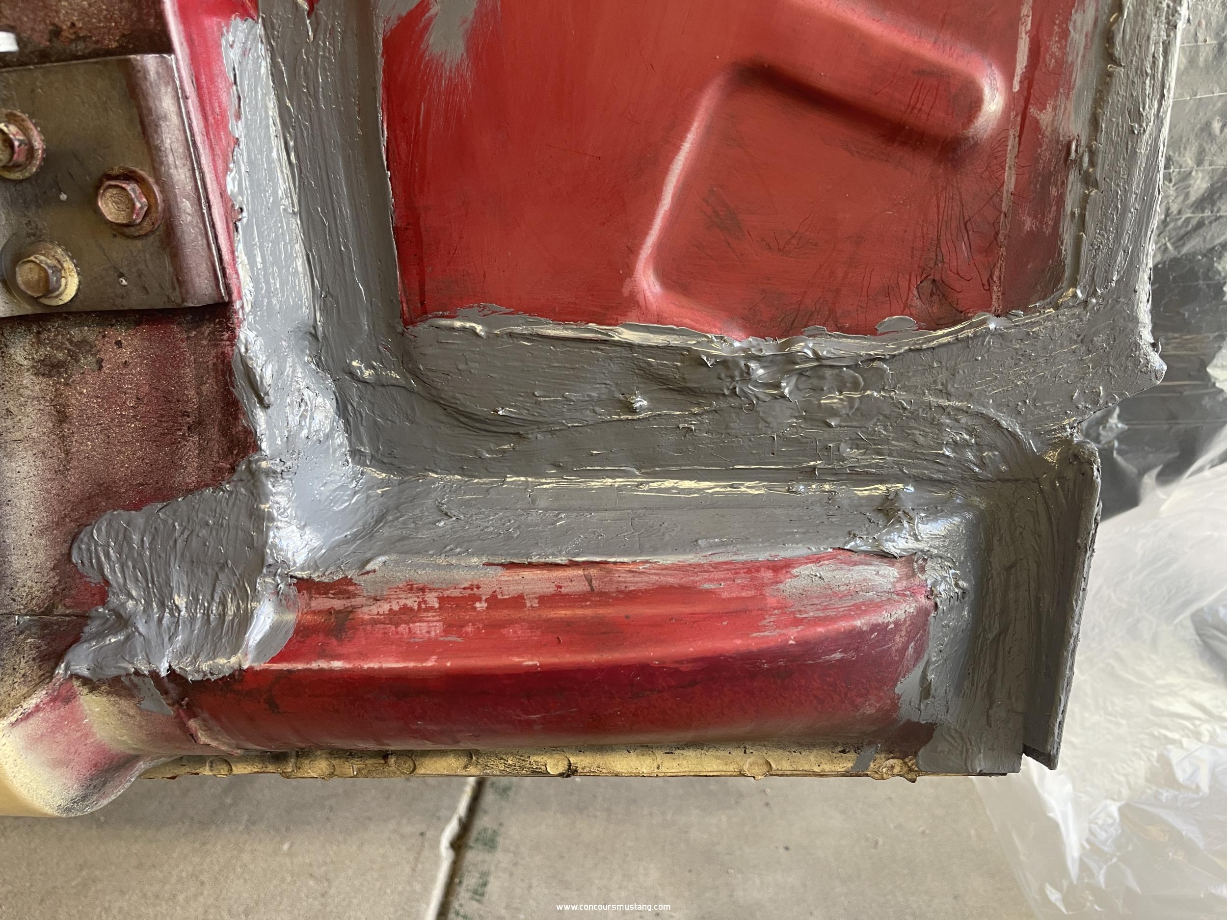

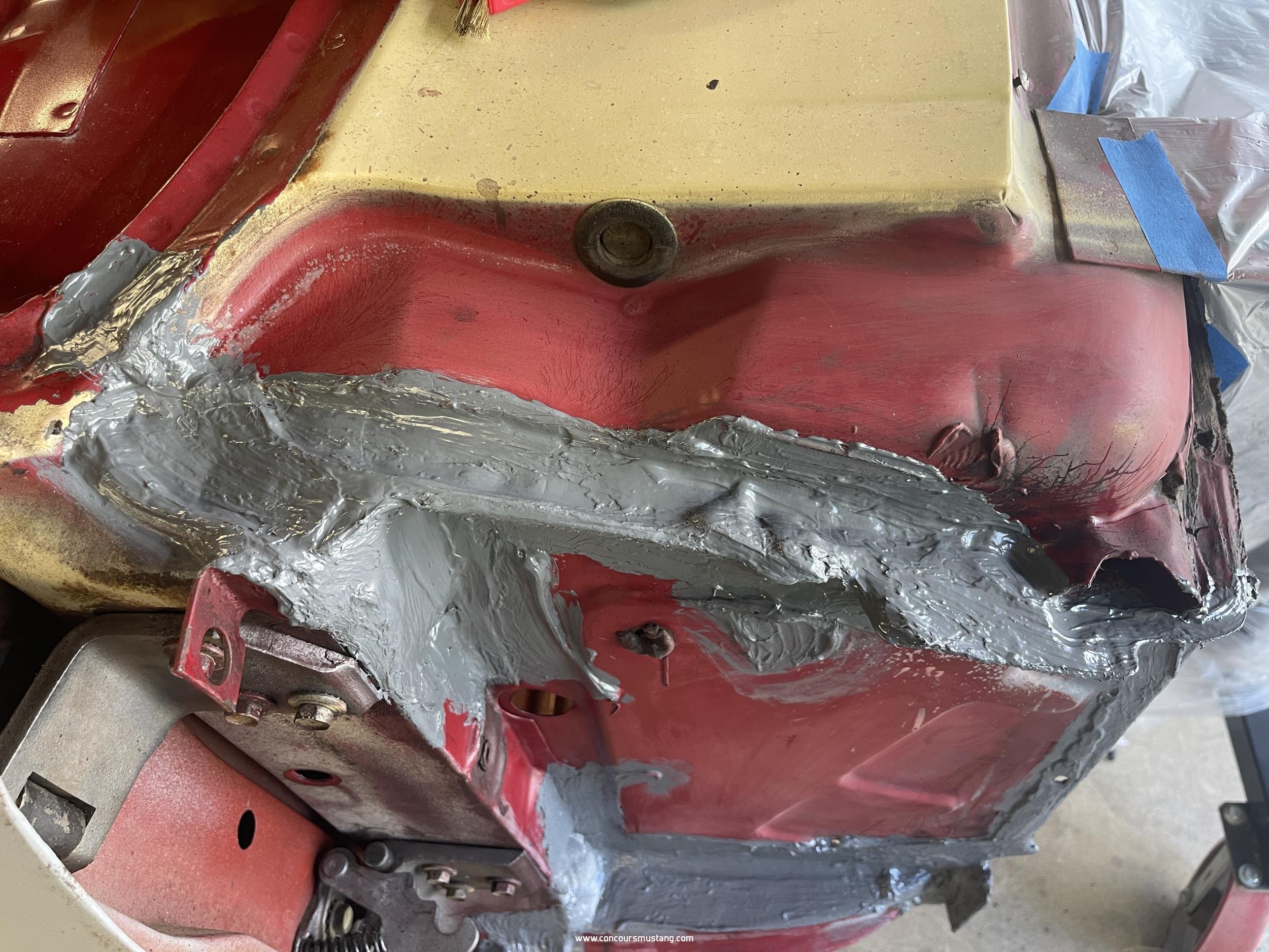

I didn't want to leave this thread hanging, so posting a couple pics after epoxy primer was applied.  It's ugly, definitely not as pretty as I would have done the sealer if I had stripped it off. But, I guess that's the way it was done.  Just wanted to test the process before prepping further for primering the entire car.

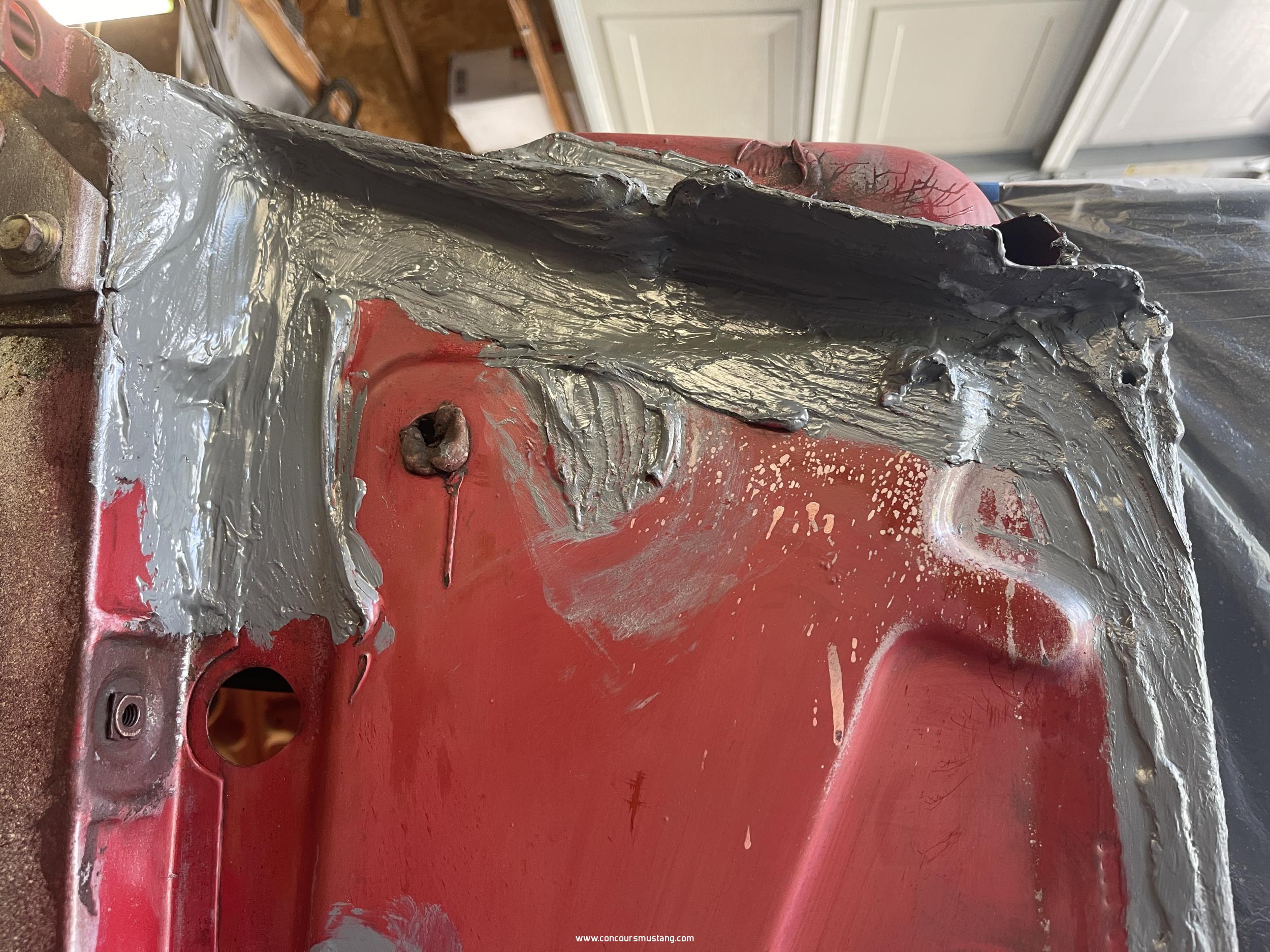

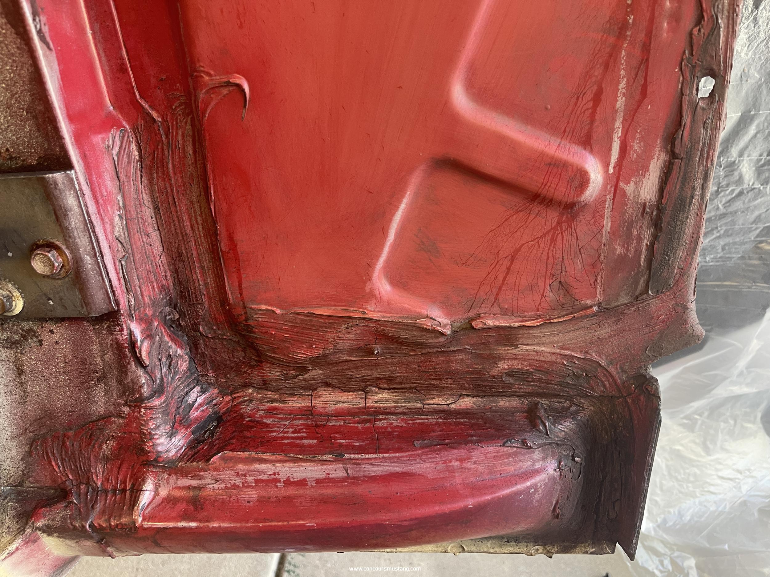

A few more pics.  I was able to reuse about 95% of the original sealer by cleaning and applying a thin coat of brush on sealer.  Big and ugly.   ::) . I used a single stage acrylic urethane 71528 from TCP for all the non-exterior areas, BC/CC will be used on exterior.
