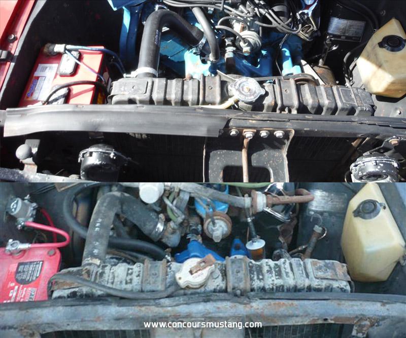

Was the rubber seal across the top of the radiator support (that was attached with staples) only installed on big block cars in 1968?

No. The 68 small blocks that I have seen the strip on had the heavy duty cooling option . The strip was meant to direct air through the radiator support and hence radiator instead of allowing it to pass over the top of the support. Maybe a coincidence or maybe tied to that option I'm not sure.

I believe six cylinders got the seal as well

San Jose early January 1968 production S-code GT with extra cooling package but no A/C.

Is it correct that the hood seal on the radiator support was installed on Mustangs in 1968 with the Extra Cooling Package option regardless of whether the car was a small or big block, with or without A/C?

Don't believe so but would have to compare pictures with Marti reports to show proof at this point

What do you think was the determining factor for installing the hood seal then if both small and big blocks had them--but not all small blocks?

Have not found any original unrestored SB with them in 68 any plants though you can find a fair number of repaired/"restored" cars with them added by owners in the thought that it would help with the efficiently of the car/cooling. Guess that is what you have been seeing at some shows or the internet.  ::)
Unfortunately Kevin Marti didn't choose to include the "extra cooling package" in his break down of options and how many cars were produced with it in his book Mustangs by the Numbers
Haven't found a Marti report or buildsheet of a 68 SB Mustang with that option on it except for 68 GT350 but like 67 GT350's that extra cooling package was part of the standard equipment for those cars as written in the specifications but these were not your regular Mustangs. Still looking through more

Finished looking through 300-400 68 Marti reports  (had more but sort of gave up for the minute  ???
Found no cars with the extra cooling package as an ordered option. As far as some models (FE, 6 cylinder and AC) it was likely part of the AC or engine type option. Did find the extra cooling package but that was for a different Ford model (rear big car) built elsewhere in a different plant that where Mustangs were built.
With that said I focused on 68 small block Mustangs and Cougars with AC built at all of the plants and found none of those (unrestored or modified cars) and none of them showed an original hood seal nor evidence of attachment from the pictures I have.

Sorry looks like I skipped over the direct response as we got sidelined with the other questions
Here are a couple of unrestored cars (early 68 S code wo/AC) for example.  Seal with staple retainers
7R0xS1094xx (top) and 7R0xS1404xx

Thank you so much for the detailed answers!
