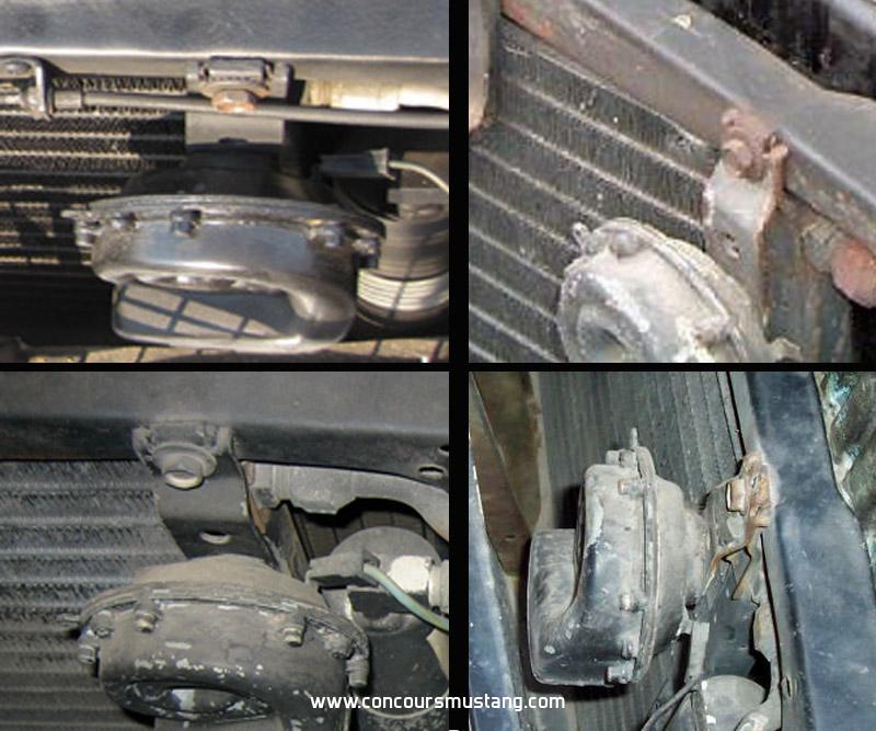

Re: 68 Low Note Horn with AC - Mounting?
« Reply #9 on: September 22, 2024, 11:14:22 PM »
Hello All,
I have 2 original horns 1 Low and 1 Hi. The confusing part is the Low Note has 2 tabs (AC car) and I can't remember how it attaches. (didn't take that photo)  If it had 1 tab in the middle like the passenger side Hi note it would be easy. The dual tab is throwing us off. Quite a few sites show the aftermarket Low notes FOR AC CARS with 2 tabs so it seems there is way.  Thanks in advance.
A little late to this discussion - sorry. There were at least a couple of pictures of this detail in the 68 section of the Unrestored Picture threads if you had tried there.  ;)
In any case for you and others later who will find this thread here are a few unrestored examples showing the attaching end of the drivers side horn on a factory AC car
For the record if it matters, the two upper examples are San Jose cars. The bottom two from Dearborn examples

Thanks Jeff
For clarification, I am working on a 12/67 Dearborn car.
