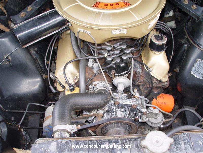

Since your new I guess you might not be familiar with the now being able to see and read all of the site. For your particular questions it has been posted before - and the search with some work would have helped there. Another source is the collection of unrestored cars shown in individual threads in the Unrestored picture section of the site. You will find it on the big main page near the bottom after all the individual Mustang sections by year
As far as sources books can often be dated with their information and may rely a lot on restored examples rather than original ones. As far as vendors you need to remember that many are focused on what they have that they can sell (not all of them) not always what was original.
Here are a few prior threads that might help answer your question. Location of the decals IMO would not differ between C or A code during this time period but they could differ depending on what plant (workers) were and their supply.
Thread with pictures from one of the cars in the Unrstored Picture Threads of a car likely built just before your car
https://www.concoursmustang.com/forum/index.php?topic=14857.msg92612#msg92612
Here is an additional picture from one of the unrestored picture thread - Car built likely a bit after yours

This is a picture of the decal on my NOS air cleaner. About 35 years ago I traded for a complete 66 HiPo air cleaner including the burgundy air filter. Base was dated 6A. The decal was on the lid. Traded the 6A base for a 5A base with Dave McDonald. It now on my 65 GT350.
Texas Swede
Re: Autolite spark plug air cleaner decal - 1965
« Reply #14 on: November 03, 2024, 11:32:11 PM »
Texas Swede
It is counter intuitive but it is typical to find the straight sticker instead of the curved one on the hipo lid.
