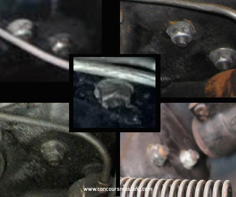

« Reply #2 on: November 12, 2024, 06:20:32 PM »
Here are some examples of what I found in the pictures I have of those items from 66 San Jose cars. Since the washer and nuts are the same finish and the washer is only slightly larger than the nut they can  from a little distance to look like shouldered nuts especially with the domed tip of the nut
