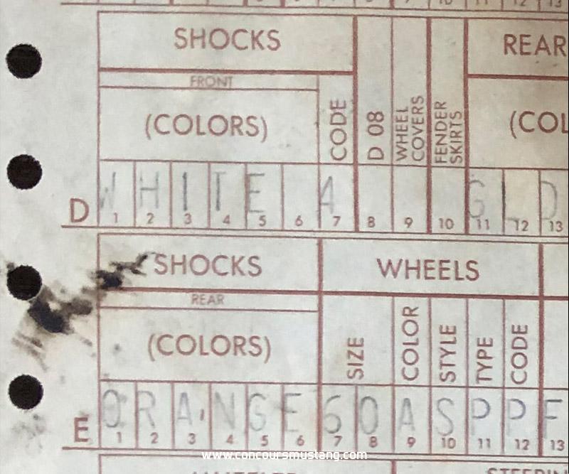

I have searched this web site for the correct paint dab on the front and rear shocks for a 69 428 SCJ 4 speed Metuchen New Jersey Car .. Can't seem to find it .  Can someone let me know what the colors are.  Thanks

Do you have your build sheet? The color codes would be on there.
I have seen white on fronts and orange on the rear of manual transmission SCJ but I that may not be correct for your application.

I have no build sheet for this car.  So I'm going with white front and orange rear shocks,  Thanks

« Reply #4 on: March 14, 2025, 04:49:13 PM »
Your good with the orange & white
69 NJ build 4 speed SCJ built around April 69
