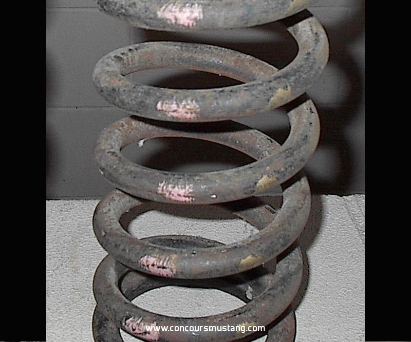

Excellent answers. As for the orientation of the stripes that IMHO also supports the coils laying on the side or up side down when marked here is a picture of a 69 Pink gold front coil spring. Often you can even see the direction as to how the stripes were applied and the related  brush marks (rounded start to the end with the bristle marks) on the application but not always if the brush was on the dry side with not as much paint or at the end of the pass
As you can see, since the spring is up side down as how it would be installed, that on this example the colors would be backwards from the buildsheet order
