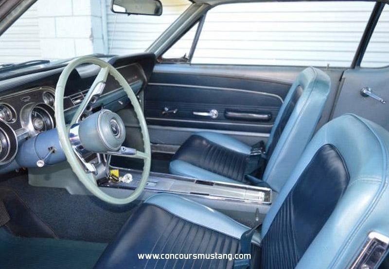

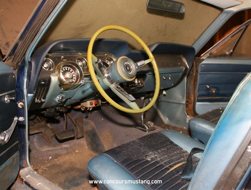

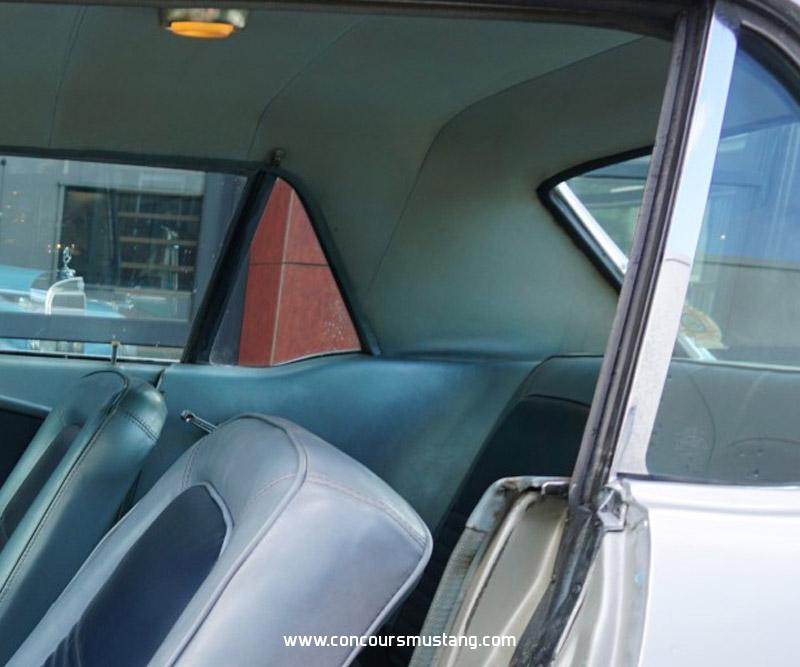

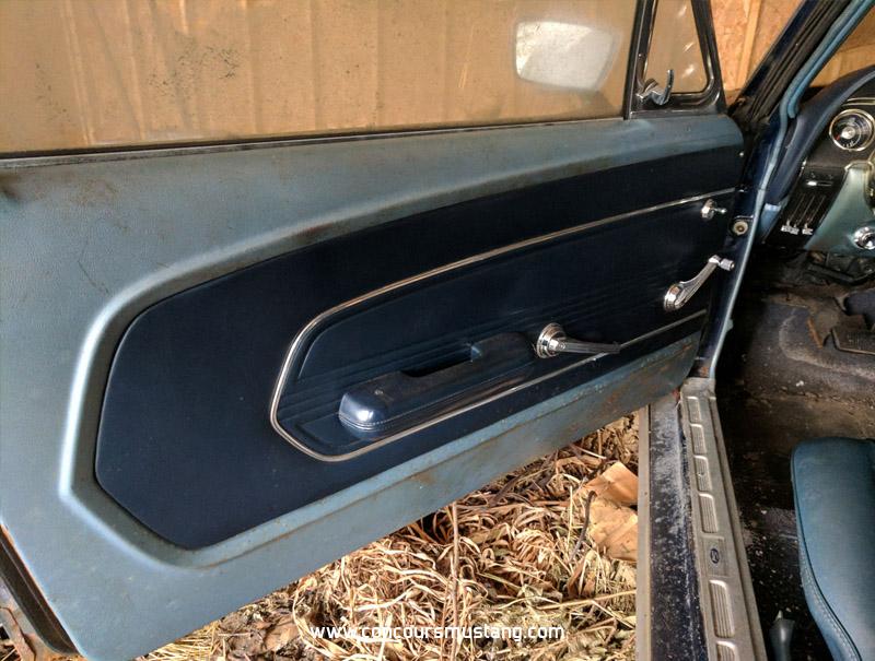

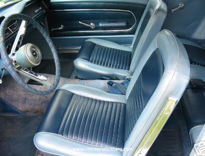

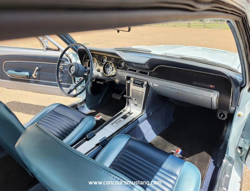

Here is a collection of unrestored 67 2B interiors to help with making your choices

Thank you Jeff for the pictures. After looking at the pictures you sent, I believe the items I had mentioned are all correct as far as what is painted light and dark blue. I don?t think I missed anything. Just have to get the correct paint codes to the body man so he can order the 2 correct colors of blue for our 67 2B coupe!! Won?t need much of the dark blue at all! And probably a quart will be enough of the dark blue.
