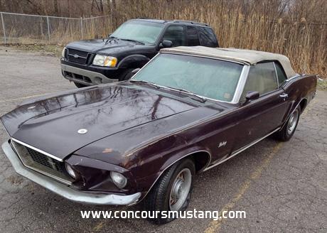

Recently purchased this 69 convertible on marketplace. It does not have a color code, a little research has me thinking it?s midnight orchid, but research also tells me there are only about 4 cars with this color. Car needs a lot of work, just starting out. I got a marti report but just states custom color. Any ideas? If it is midnight orchid how rare is it and what does it mean for rebuild?

Sure looks like midnight orchid mettalic as its a RARE one year only color offered on the 69 t-bird . 2 69 mach 1s were special ordered purple and my 69 shelby gt500 drag pack vert and the color code M32J  3204  is on my buildsheet in the bottom remarks section . There was a magazine story and photos taken as ford tulsa meet back a few years ago with these 3 purple cars featured in it.  My shelby was special ordered to match a  purple 69 t-bird the guy ordered for his wife after he inherited a large sum of $.

The fact you have no paint color means you have a special paint color. Special paints were offered during the 1960s and there was a special paint book prospective buyers and dealers could use to order the color of their choice.  There was an additional fee.
I am not sure where you found the number of "four cars"?? The truth is Ford recorded the fact your car was a special paint color, but they did not record the specific code or shade in their records. There were literally thousands of special paint cars and there are no records to say how many were any specific shade.
Paint manufacturers made colors available to all car companies. Theoretically Ford and GM could have the same paint color with a totally different name. Ford even changed the names on a yearly basis in some cases. One example is Poppy Red, it would become a special paint color (denoted WT5185)  and later Calypso Coral. Sometimes dealers even gave special paint colors their own names. The Mercury line also had unique names for the same colors. Cougars and Mustangs were painted with the same paint and the names were very different.
Matching your paint is a good idea. The problem with that is you are going to get the closest modern version of the paint formula in the computer. Its is unlikely 1960s colors are even recognized today.  Over the last 60 years paint formulas have changed for various reasons. This is why matching the paint has become a challenge.
I doubt you can not get the color name from any service or Ford. If you are really lucky you might find the original owner or the original dealer and determine if it was some type of special order or promotion.  If you're lucky enough to find a build sheet it should have some codes on it.
I would also add a weird color does not mean the car is more valuable in my opinion, its just different

That statement can't be true since Ford didn't keep records of the colors for each special order paint. In some situations where there was a group of cars ordered under the same DSO and one of those cars has had the original color determined then and only then can the color be confirmed. Maybe someone was referring to someone had documented or found 4 cars they believed were originally that color.  That IMO would likely be more possible
For example you can see a list of special order paint colors by number that made up the 1969 Color of the Rainbow promotion in an article in the Library on 69 Paint Colors

Yes if you use the search feature you can read a fair amount about specific order exterior paint cars. There is also at least one, short as it might be, of an earlier discussion on a car they felt or determined was possibly a Midnight Orchid 69.  Only way to determine what your cars original color was is to find the original DSO paperwork included in the original paperwork - in the glove box, a notation at the bottom of one of your cars build sheets or by comparing a good sample of your original paint to someones Fleet color book

A friend Ed Meyer owns a Midnight Orchid 69 GT500 special ordered paint car. He is specialed on this forum. You might be able to get confirmation from him by sending him a sample. Computer monitors can be deceiving with varying tints. ;)

I had a midnight orchard mach1 many years ago. There was nothing special about the car other than the paint. I still have the passengers door that was swapped out due to damage which you can still see the original paint on the inside. Vin 9F02H168xxx, body 63C, paint 5, trim 3WA, date 12C, DSO 247564, axle 6, trans 1

Here is another that was identified "midnight orchid"   There were a lot of different colors in the fleet book so slight variations would have been a different code and color

I?m pretty sure this is my car. Where was this pic from?

Can't always recall where pictures of each car came from that I've collected pictures of. Could be from a sales ad, earlier owner, shop, forum post or sent directly to me.
Have five pictures and a copy of the Marti report so far. Car was competed at Dearborn on Feb 2nd 1969
