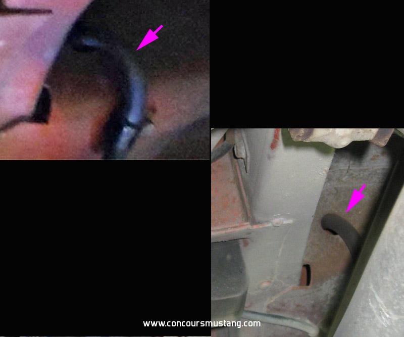

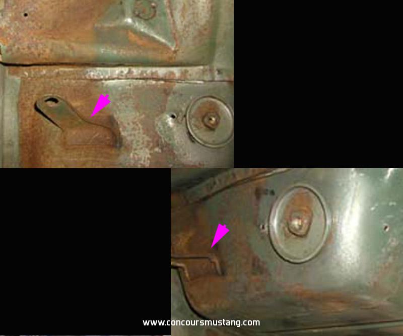

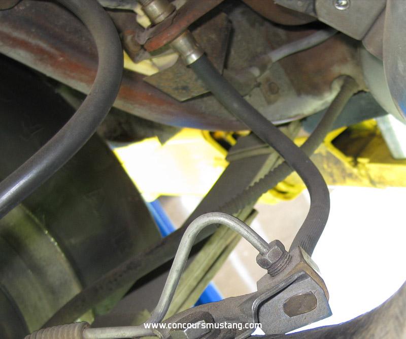

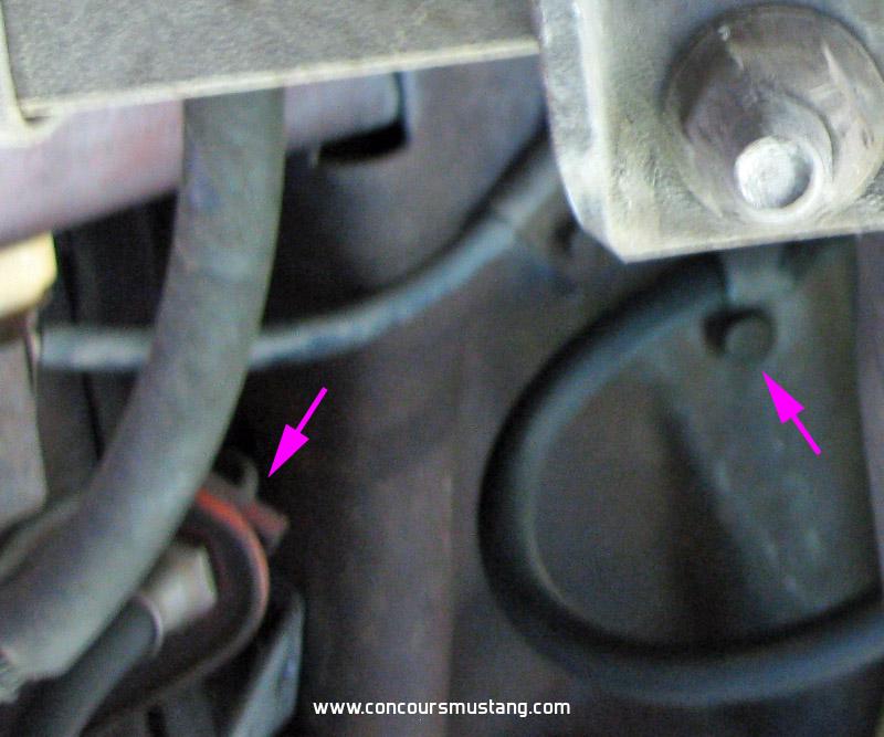

I was wondering if anyone would post a picture of the ?L? bracket that supports the union of the rear brake hard line and the rear brake hose? I would also appreciate a picture of where the vent hose goes into the underside of the floor. If possible, please take the picture far enough away that I can see its relationship with surrounding parts. Thanks!

From dual exhaust staggered shock applications from 1970 Dearborn. Likely have more but these were fairly handy.
If this is not what you needed let us know
Floor bracket
Rearend to bracket hose
Brake flex hose retainers
Rearend vent to unibody hole
