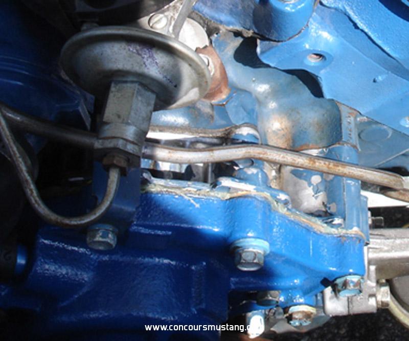

Couple of examples that appear to agree with one another. Both from around your cars production period

Thanks Jeff for those great examples. They do appear to agree with each other as well as with the AMK kit.  :)
