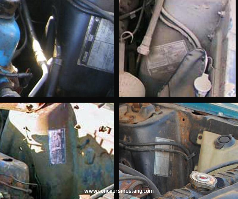

Assuming that you meant that you have a NJ built 67 Mustang completed in December 1966 here are just four pictures of original service decals and how workers placed them. Appears that there were a number of different ways (orientation) that the worker on each shift choose to apply this specific decals if they even considered it. They might have given it some thought since its rarely applied like the assembly manuals/Ford engineers in the big office, wanted them to apply it.
ECS is a great source IMO for decals. A number of members have donated or worked with them to get some decals made and available or improved over what other suppliers provide. There are also a few areas where addition research should be done to determine if what they have is correct for your specific car and plant. They are few that I'm aware of but just a not of caution and responsibility on each owner or builder like most details.
