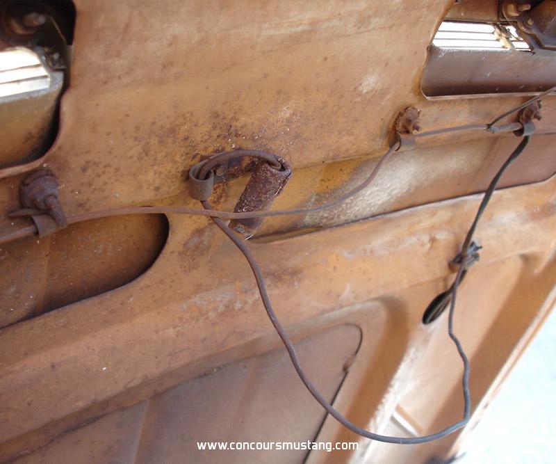

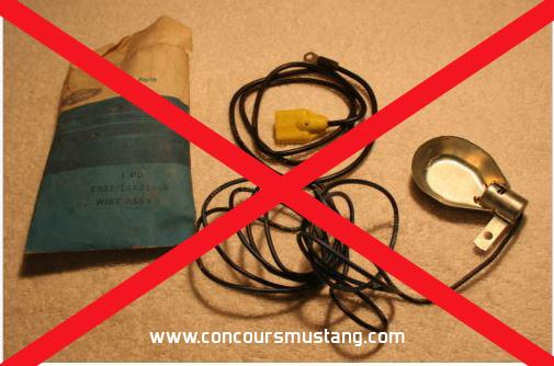

Here is what the C9ZZ_14A318-A lit looked like
What you show looks similar (if there is an internal mercury switch) to what was used in earlier years  (68 example shown)  and for trunk lights but the mounting brackets appears to be shaped differently to me at this point
Could not find any pictures of those out of the trunk lid and such but here is an original for a 68 attached. As we can see the light and the wiring is different than what you show. Don't know at the moment if the one below is missing the shield or every had one. Trunk ones typically don't

Jeff the part number C9ZZ-14A318-A is for the power lead from the fuse box. The light in the picture is a dome light for a coupe. The under hood light for 1969 is very similar to the 1968 version with a C9 part number

Thanks for catching that and I'll figure someway to alter the post above to show it not being correct for the thread. DONE
That is what happens when you rush and also place a picture in the wrong sub directory.  >:( Bound to happen from time to time but the important thing is providing the correct info for those asking
