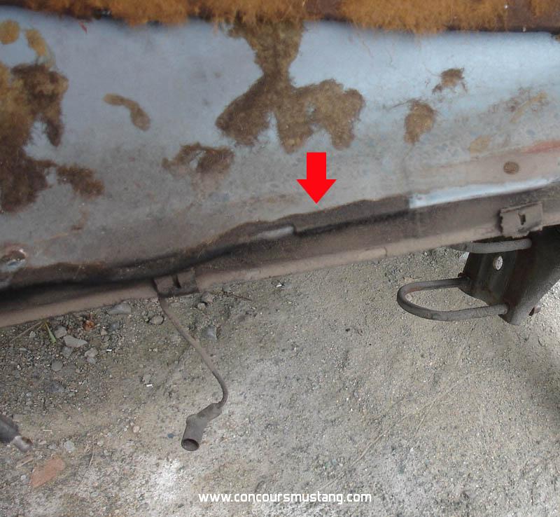

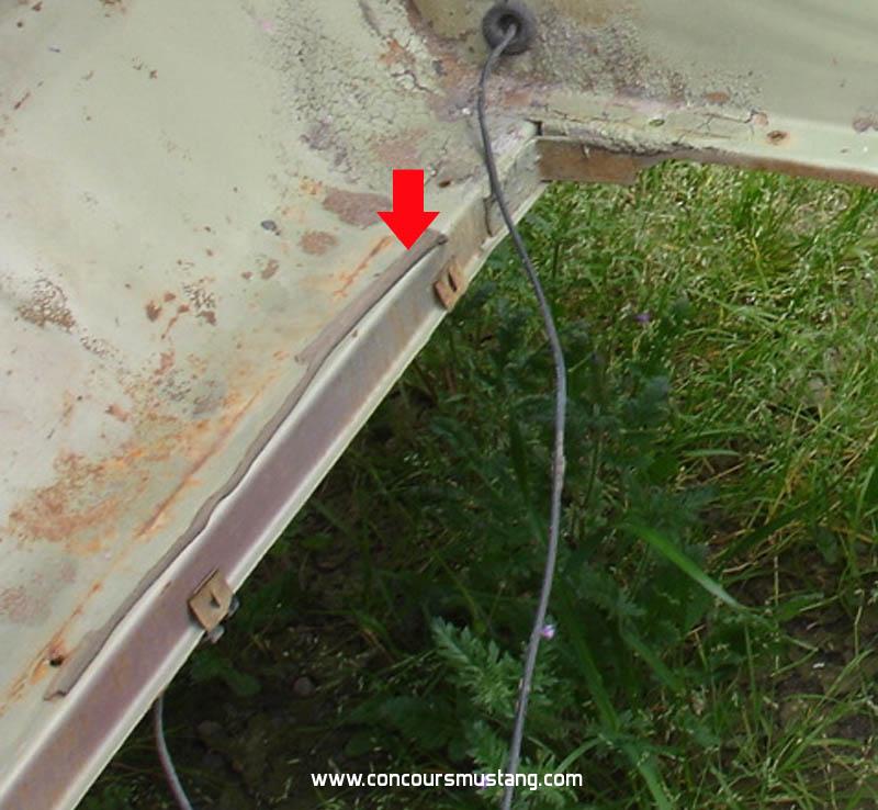

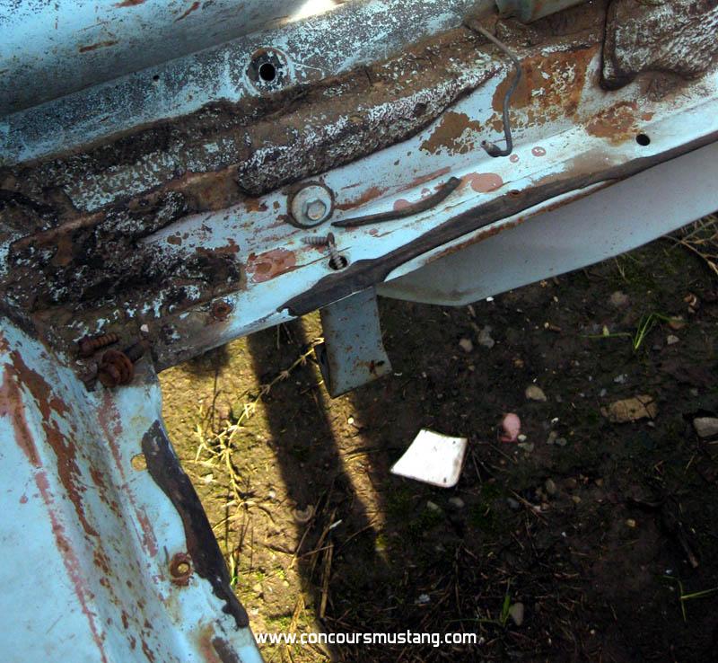

Gas tank typically very little - more (slightly) looking from underneath
Here are some examples. Less product used to seal compared to the fender application. Remember the color of the strip is affected/changes over time and with exposure to the sun and the air
Fenders often none IMHO was not covered. Every once in a while you might find a car where the end of the strand slide out but from the tens of thousands I've seen this was not the norm. Many of the picture threads of unrestored 67 San Jose and even 68's here on the sight will provide you with some examples
