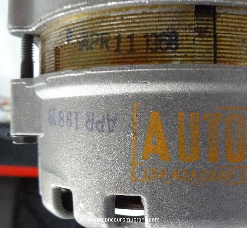

Just so we don't get confused here ;) You should note that the ones pictured above is a 65-66 version/alternator rather than a 68 version
68 rear main case is molded differently and is shaped (center raised area around the rear bearing retainer) like a tear drop rather than a round one in those pictures
Here is a 68 dated example of a C6AF-B

Jeff : Yes, you of course correct. Thanks for clarifying that. My intent was just to show variations of stamping colors and more than one date stamping, but see how the actual Alternator picture could cloud the issue.
Just to be clear for Ralf, his 67 Alternator should look like the one you pictured, and with the appropriate color stamping as previously noted,

Ok, thx for clarification.
One thing......I saw Autolite as well as Motorcraft Logos casted on the backside....
Not the case in above pics.

All depends on the time period when the back half's were cast. You start seeing AUTOLITE castings in the later part of 68 production so it doesn't apply to this discussion
