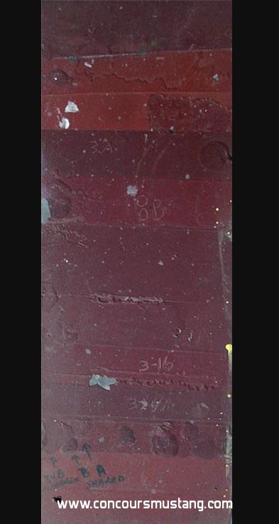

You might want to create a sample board for long term use as mentioned in a couple of other threads. Take a piece of strap metal, gusset or similar piece of metal, buy a hand full potential spray cans and paint stripes (maybe an inch or two wide) along the length of each color then use it as a guide to which black you want to use on any particular part in the future or to compare to original paint samples to chose the closest match.  Black painted parts, for example, in the engine compartment, would not have originally all been the same since they were painted at different locations, with different paint supplier, mixes and conditions so this can help with that also.
Here is a similar test or sample board I used for floor/undercarriage colors
