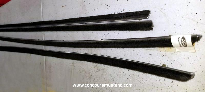

We must be using different terms for different items. On a Mustang shops, web sites and (not sure but believe) Ford uses the term "beltline" as the strips (rubber and/or fuzzies) at the roll-up window openings both on the inside and exterior surface.
65-66 (C5ZZ) version/style grabbed from an EBay ad recently
