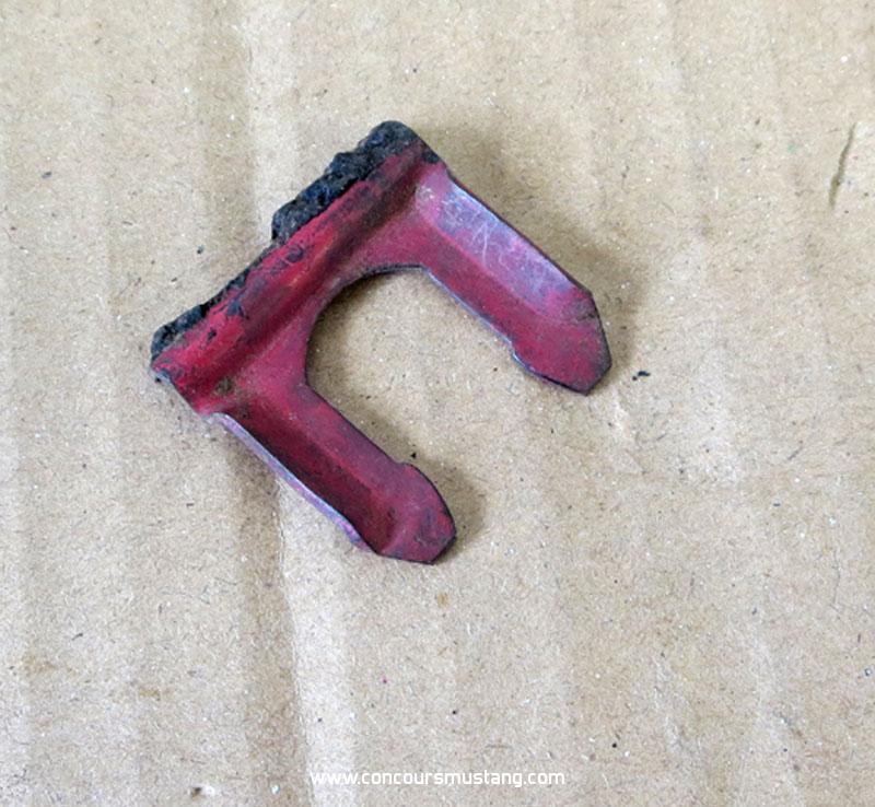

For example the brake line clips for some years appear to have an opaque finish while other years they don't always seem to look as "pasty". You can make out the uneven coating (dye job) along the top of the picture where there are runs and build-up in the lower surfaces and bends of the metal where it collected during drying

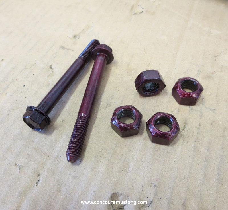

I did a bit of playing around with the inks today to see what I can come up with.
First by mixing the transparent ink with opaque ink in different quantity but really just made it glossy and a little transparent.
Phosphate
Zinc & chromate
Next I thinned the opaque ink out and that made it a cloudy transparent ink.
Zinc & chromate
Phosphate
This look like the same as the bolts I took out of the steering box when it was pulled apart.
Chromate
AMK dyeing nut.
