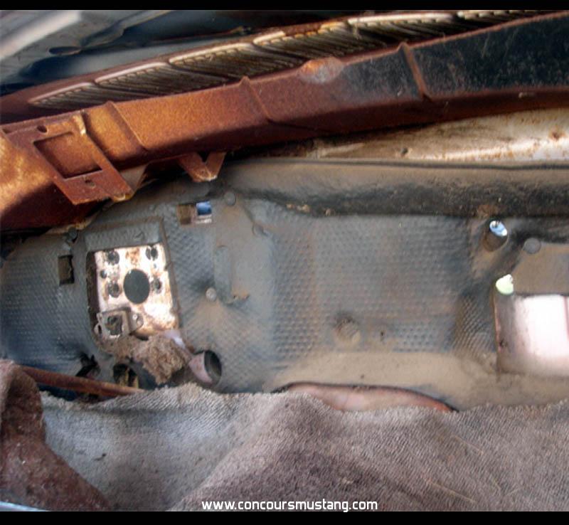

Trying to see if I can determine some general or specific change over periods for each of the different firewall pads used at San Jose in 65.
We realize that the typical/normal pad was produced and supplied by a different  sub contractor than the other plants (like many parts) characterized by a "dimpled" or "off set pegboard" surface
Major difference appears to be the punch outs for the AC hoses. So far I've got the
1- No punch out
2- Vertical oval ended punch out
3- Vertical square corner punch out
4- Horizontal (angled up at passenger end) oval ended punch out
Here are a few examples
No punch
Some may notice the early clutch rod seal in the example below

Those firewall pads just aren't san jose seen them in many early dearborn cars.  Just took apart an original 64 1/2 pace car coupe built april 17th 1964 with the pad you show in the pictures
