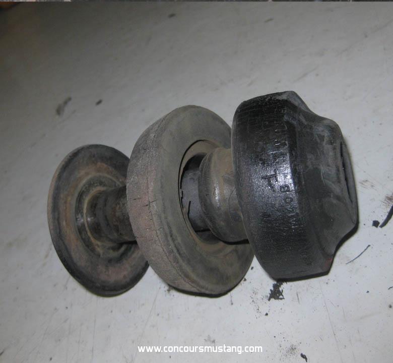

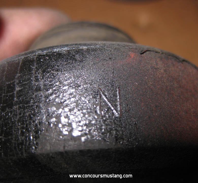

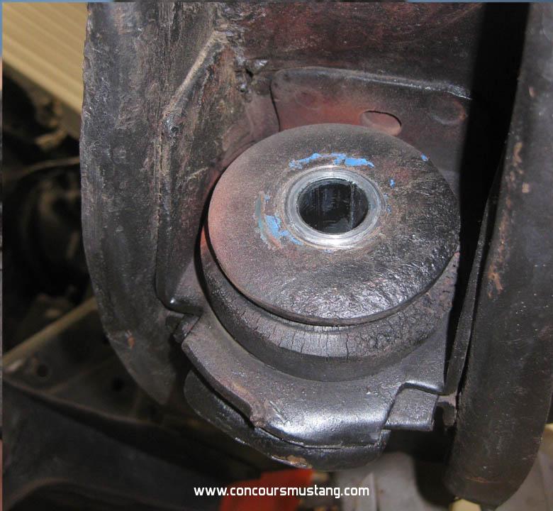

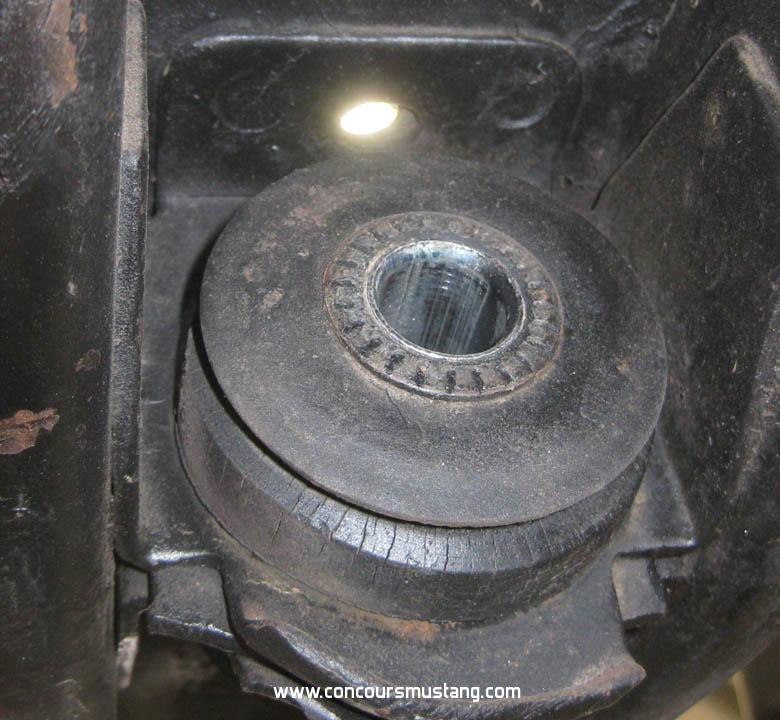

Since the subject of strut rod bushings came up in another thread and I uploaded a bunch of pictures of the originals I removed from this car I thought it would best serve the members that they get posted here so that others using the search feature could find them here
Face of front strut rod washer and bushing. Seen a few rattle can passes of black paint over its short 30K miles  :( But it did protect the finish under the black. You can still make out the blue (often found teal also) peeking out through a chip or two int he black
Back side of the bushing assembly - more black rattle can

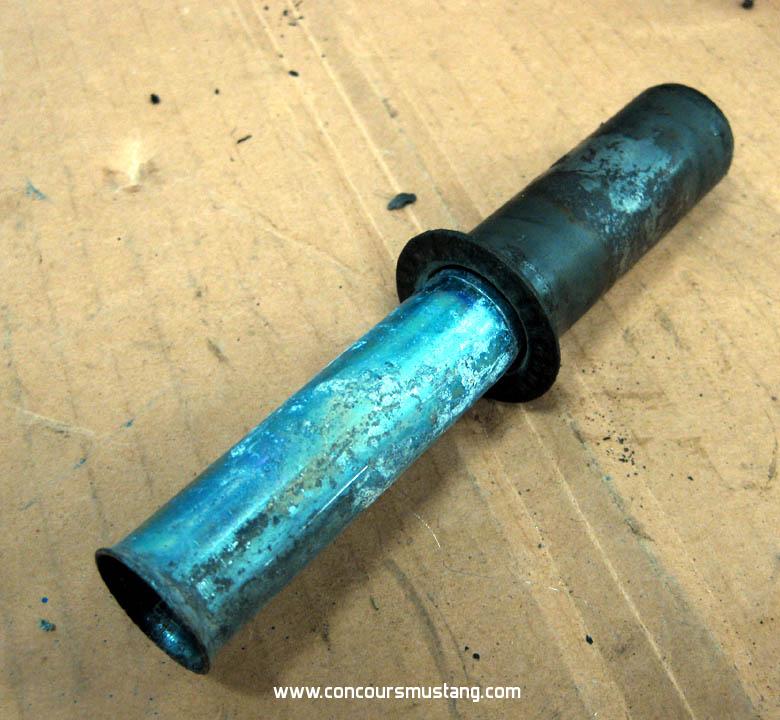

After the lip of the inner steel liner was removed with a careful application of a small grinder and some hand tools the assembly (minus front bushing) reassembled to show the order and direction of each bushing as found on car.

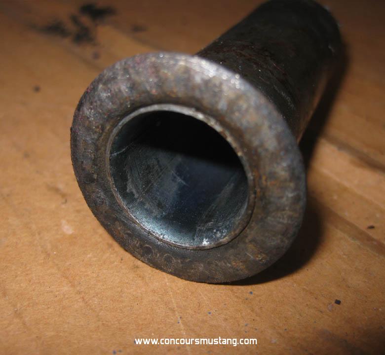

Both longer and shorter inner steel liners together
Just the shorter liner. Notice the small amount of markings on the lip of the liner at the bottom

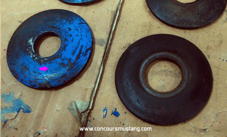

Front and rear washers (painted is the forward washer) Front washer shows a "flying" F in a circle

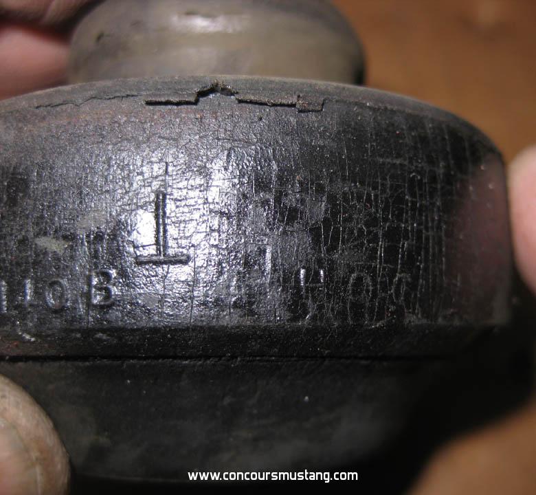

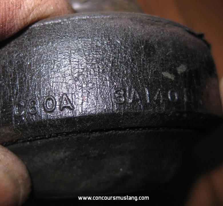

C8OA-3A140B rubber insulator markings
Inverted T and a HOC (possibly supplier) markings
Engineering numbers

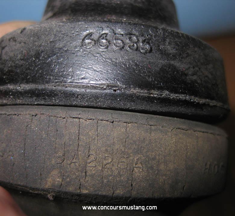

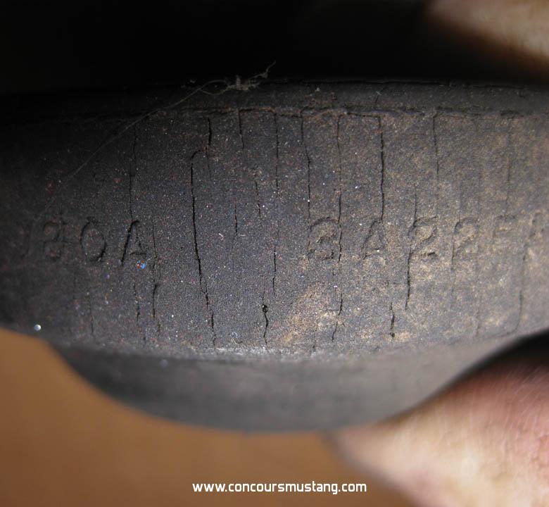

C8OA-3A225A rubber insulator markings (bottom most is the original)
