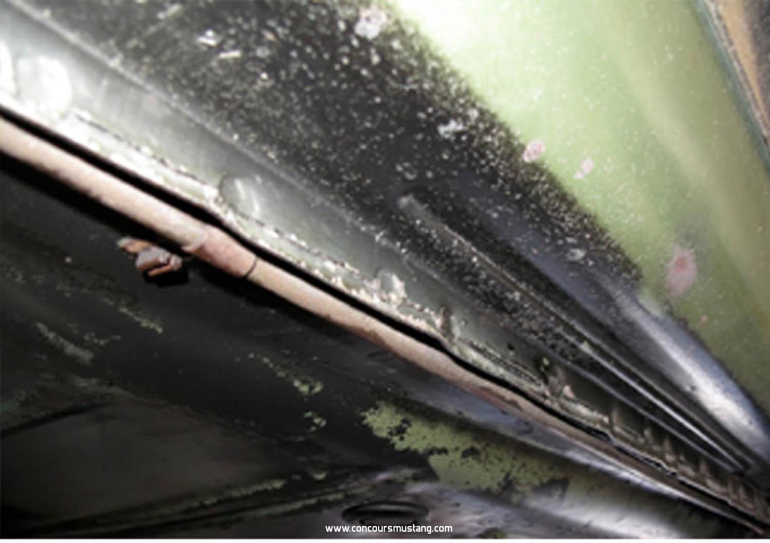

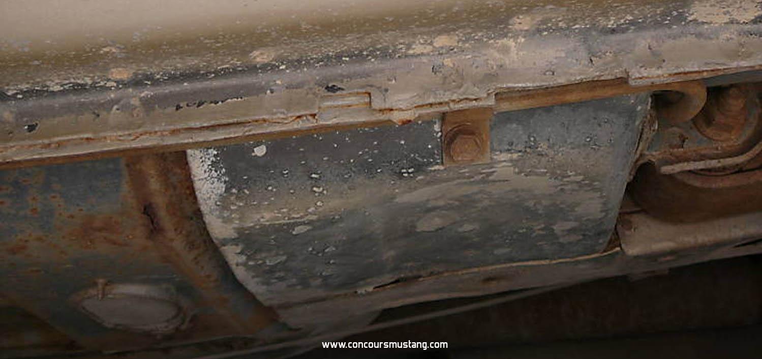

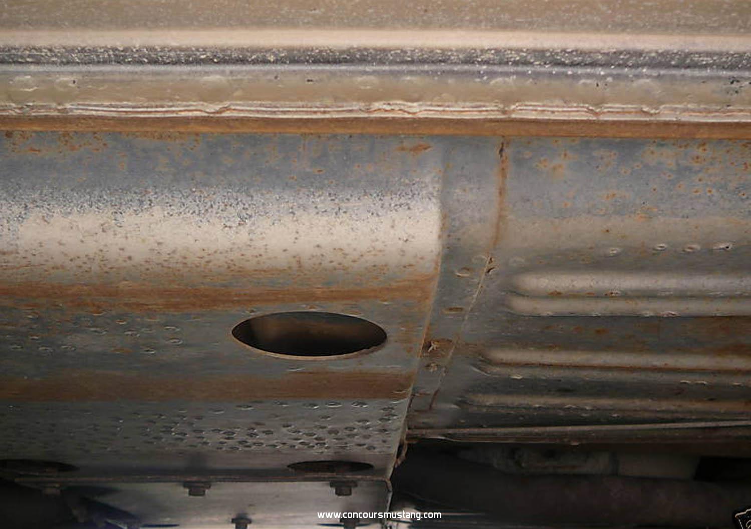

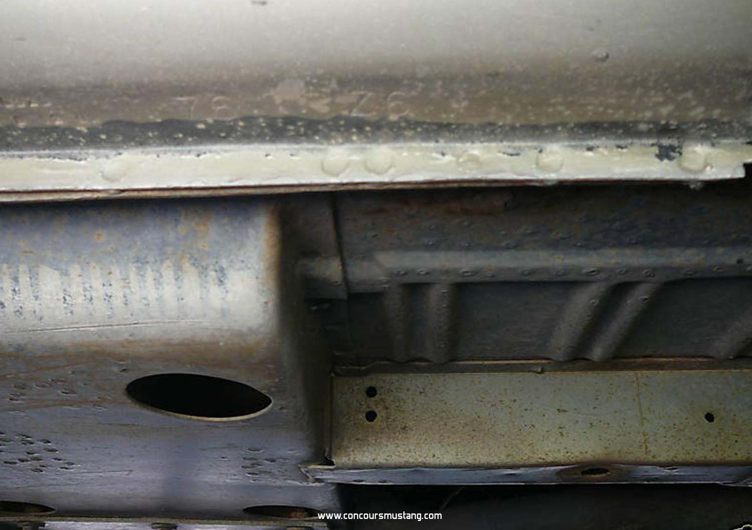

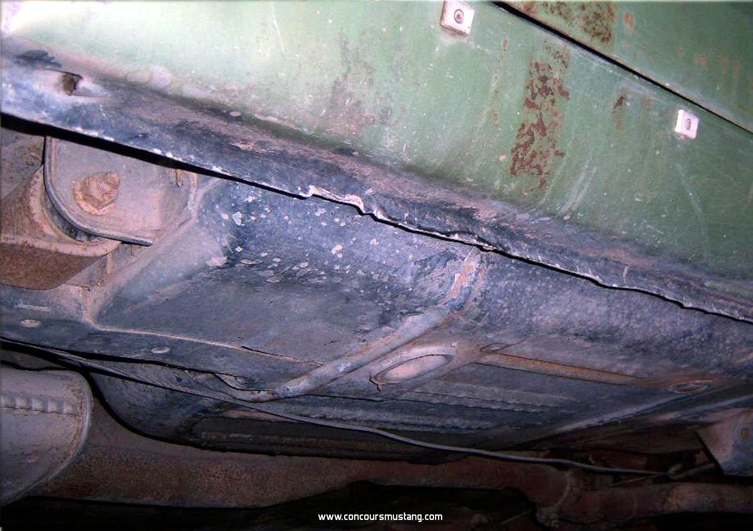

Unfortunately I often don't take allot of pictures of details that seem to be so normal and areas where I don't get allot of questions on but here are some examples from that year and plant. You will see a variation as to how far out on the rocker the "edge" is"  and understand that because of age, cleaning and time about 50% of the overspray (the lighter stuff) has disappeared over time
You can see there the surface of the body was close to the gun it produced heavy runs where those further in distance just a spray. Allot depended on the worker and how close they held the gun and the angle
Last note - Stating and stopping the gun once it passed into the rear wheelwell (front and rear of wheel well) produced larger amounts of overspray to be applied into the back of the wheelwell and frame areas visible in that area over the body color. Didn't cover a large area but can be seen in most original paint car examples
Hope this helps - Makes a really big improvement as to how the finished car looks and once you've paid attention to this detail all the cars you see without it will look unfinished. Even got the resto mod guys around here to copy the idea - though they are allot neater with its application LOL

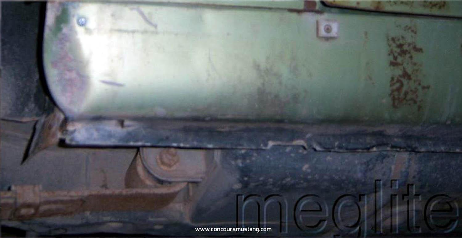

Brian - no doubt in my mind your car should have had the pinch weld blackout.  Must have been a Metuchen thing  ::)
Here is my red 3/69 built San Jose car;
Jim
