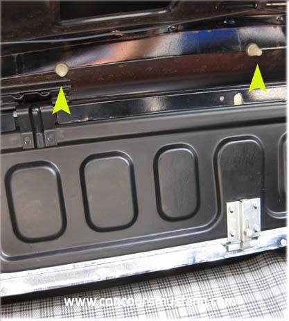

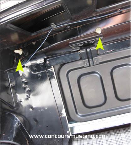

From another thread....continuing a discussion on trunk screw protectors....
5R09C1509xx  Trunk details
Again - details contained in these pictures apply to San Jose built fastbacks  at the same time as this car
Area below the rear window. Typical little or no coverage of exterior color. Notice (I did :)  that when they put the interior back together they used screws rather than rivets :(  and choose to move the screw protectors from the screws above to these screws. Nice original screw covers/protectors - just too bad they are in the wrong spots
Till next time ;)

I'm not seeing the screws vs. rivets you mentioned however, and the screw covers seem to be in the same position as mine.  Picture below.  Can you clarify?

Where yours and the car in the pictures has your screw protectors installed are where they used rivets from the factory - so no reason to have them originally installed there and nothing (originally) was there to hold them in in place. Instead they were installed on the trunk end of the screws that held the interior trim to the body as a the sharp end of the screws stuck into the trunk area and produced a concern.
It appears that some prior owner did the same as as this one - used screws or small bolts in place of the rivets when they removed and reinstalled the inner panels
