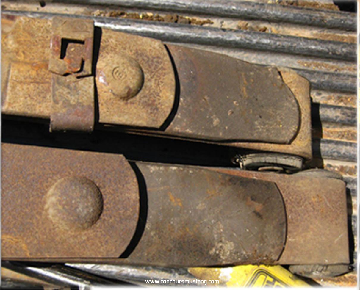

New here but am 2nd owner of 6T09K127xxx for 34 years.
Has anyone seen these bands before? Don't believe original owner ever replaced or had a reason to. I know that I haven't.

Never seen those used before on originals. Have you looked for a factory stamp on the short leaf/leaves and what did that provide?
Here is an example from a 66 NJ car - though built after your car by a few months
In this case there are springs from two different suppliers that were installed on the car when it was thrown down

I don't see any part numbers stamped but springs show their age in surface corrosion and pitting. Have them wrapped in evapo rust soaked shop towels and plastic now, may uncover something but not too hopeful.
The dimples look more like the style on the bottom in your pic however the style of the middle (darker spring) in your pics do not match mine and mine also do not extend to where the bushing is.
Just to confirm, are the springs in your pic from a hipo? Build sheet says mine are a Z
Not sure why the two leaves are a slightly different color over all these years - IMHO would not focus on that given that they are 50 years old and untouched
Since you asked about NJ rear springs not sure that it will make any difference - don't believe any spring supplier used different clamps on just K codes or provided only springs for one of a dozen needed on the line. They didn't at the other plants - some using the same suppliers. K codes used the same rear springs as most if not all of the 66 GT equipped Mustangs - C4ZA- 5556-S from what I've found
Hopefully you can find the stampings with the dates. This might provide some additional clues

Been investigating my rear springs situation and I did connect with the original owner, his answer was he didn't remember changing springs but thought about it so he might have..? :-\
I pulled the bottom 3 leafs and the aligning bolts were a dead give away that he had opened them up at some point...a hex head bolt partially rounded off and threads apparently cut with hacksaw and snapped to shorten. (I know he had Shelby under ride bars and roll bar on when he raced it. He also gave me some lowering blocks so no surprise he was unbolting pieces at some point)
The bottom spring is not only missing a part number and paint but also missing a dimple at one end, otherwise the shape seems correct. The other leaves look to be an exact match to what I've seen restored on this site.
I have a new set still wrapped from VA Mustang purchased 10+ years ago. The bottom spring has square ends and the other leafs taper out slightly before rounding off at the end rather than taper in as I've seen here. (See middle pic below...end of top spring came off my car and end of bottom spring is old VA Mustang)
I spoke with VA this morning and they now claim to have springs with a rounded bottom spring that is visually correct...not sure about the others. Has anyone seen or used these recently?
I also spoke with Eaton and their bottom springs are not rounded at the end...not sure how the others taper at the end?
And for those who have seen everything, I had 1 rubber squeak pad that wasn't shredded beyond recognition. Do the 2 round mold impressions on the side and part number on the inside and arrows look like what would have been on an original?
