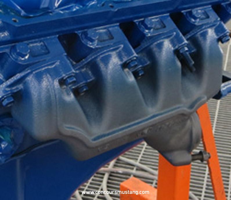

Just for reference, I painted the exhaust manifolds on my 66 "K" Fastback about two years ago with Eastwood Stainless Steel Coating Hi Temp 1200F brush on paint and here are a couple of pictures. I've tried McKay Graphite Spray that looks good but doesn't last.
+1...Have used Eastwoods stainless brush on coating for years on several different Mustangs and have never had any problems. On our '69 Mach1, I applied Eastwoods stainless brush on back in 1994. And up until 2008, when I had to pull the motor and rebuild it, it looked as good as the day I applied it.

I've been using a ceramic paint applied with a gun then heat treated.  Some others have used it for cast iron transmission cases and tail shaft housings.
Stuff's not cheap but does not tale allot. Plus you don't want much on the manifolds both for looks and durability. Picture of the product I've been using that has been posted before

I'm actually about to do my exhaust manifolds again since my engine is out of the car and was wondering about what you said above about applying that stuff with a gun. I have the same stuff you show and was wondering if you thin it out or what your process is for spraying it. I know you probably want a pretty light coat, just enough to cover it so you don't fill in the manifolds casting details or have it look "thick" and painted on. Just curious if you thin it with something for use in a spay gun I guess is my question :)
