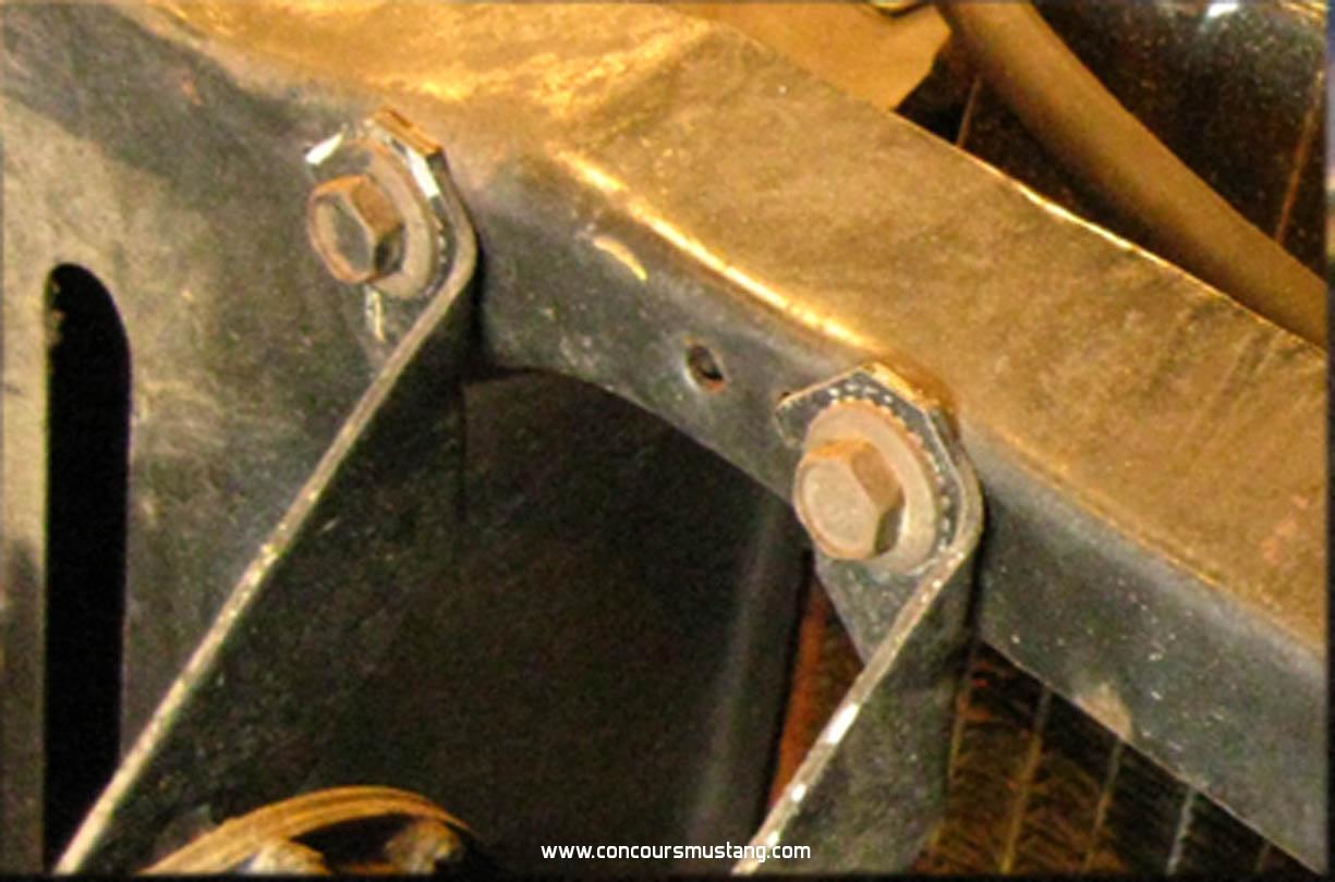

Well, it's no wonder they had to add a grounding wire for the horns, what with the reinforcing bracket in between that serrated bolt head and the radiator support.
So basically they ended up connecting the horn to the reinforcing bracket.
I thought only the '69 cars got the reinforcing plate.  So how (relatively) common were the reinforcing plates on the '70 oil cooler cars?

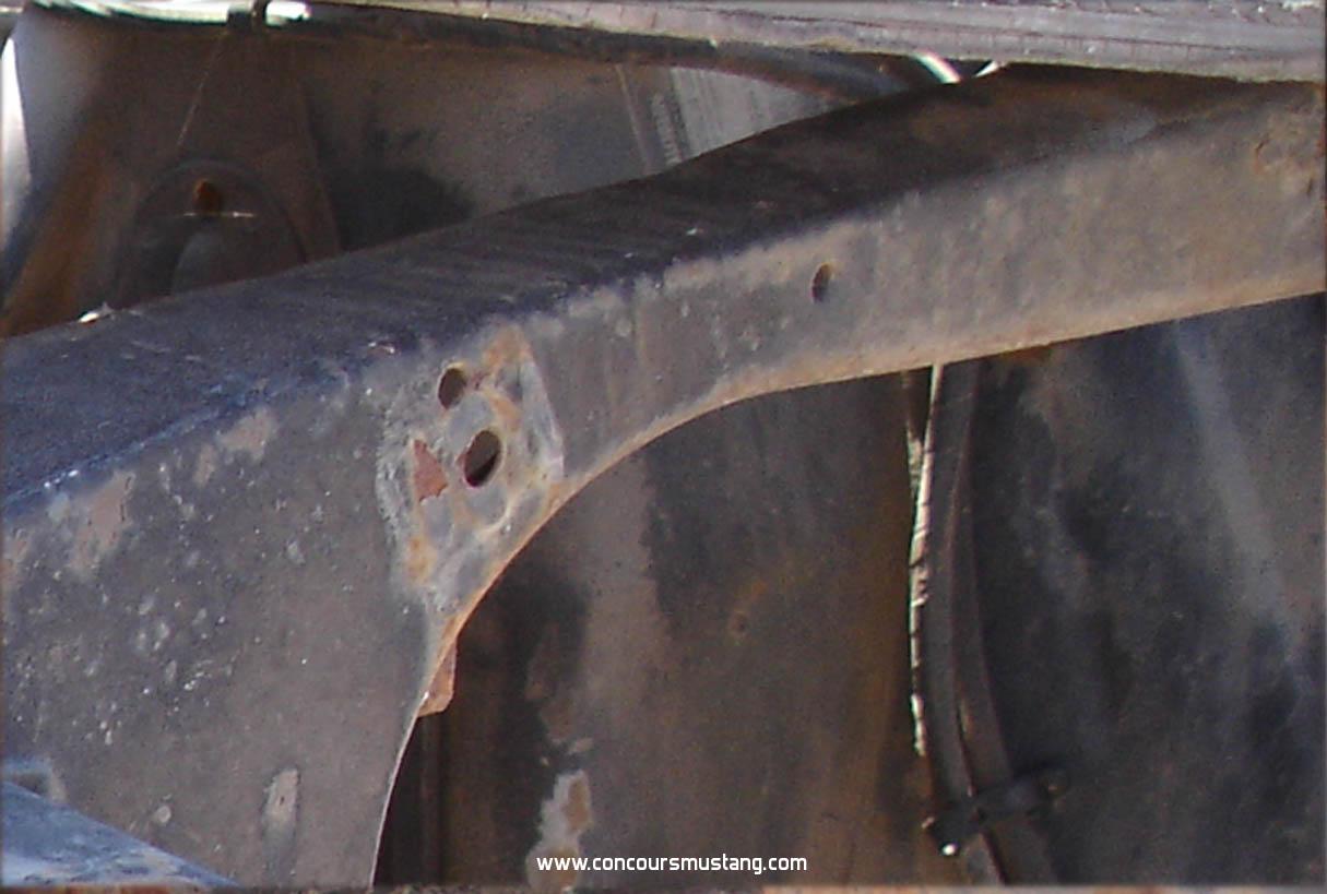

The re-inforcement plate was not always on these cars....cant say what precentage only that they should have been and just were not always there.  If you have an original paint car its possible to see if the plate was there based on the marks left (or not left) by the bolts.

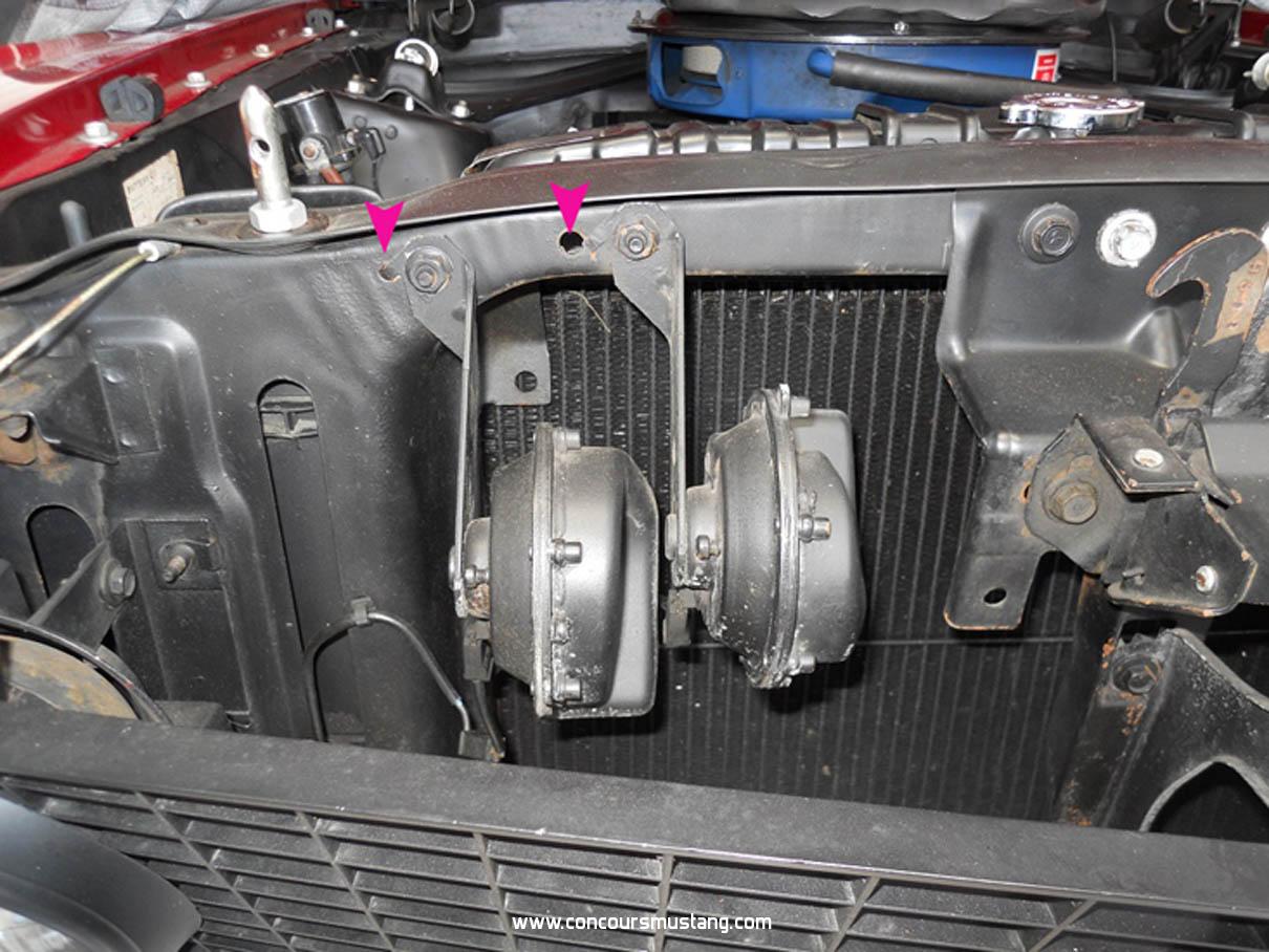

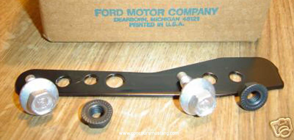

     Question about the horn bracket holes:  if two are for the horns what could the other three be for ?    Just curious,  Thanks.  Brian
« Last Edit: June 27, 2014, 10:22:49 PM by Brian Conway »
5RO9A GT  4 Spd Built 5/29/65
9TO2R SCJ 4 Spd Built 9/19/68
Owner Driver Mechanic
San Diego, Ca.
Re: 1969 and 1970 Horns with and without oil cooler
« Reply #21 on: June 27, 2014, 10:42:07 PM »
What three Brian?
The ones to the left of the horn mounting holes (where the bolts pass through)  are indexing holes for the tabs at the horn bases. IF those are the ones your referring to
Does look like the arrow on the right, in the picture, is pointing to a hole that is a bit bigger than allot of the others I'm looking at but maybe its just than angle of the picture
These ??

Must be the support/reinforcement bracket your referring to
In that case there would be one extra hole that went unused - but I've got no idea why that one is there. The other 4 would be for the mounting and indexing

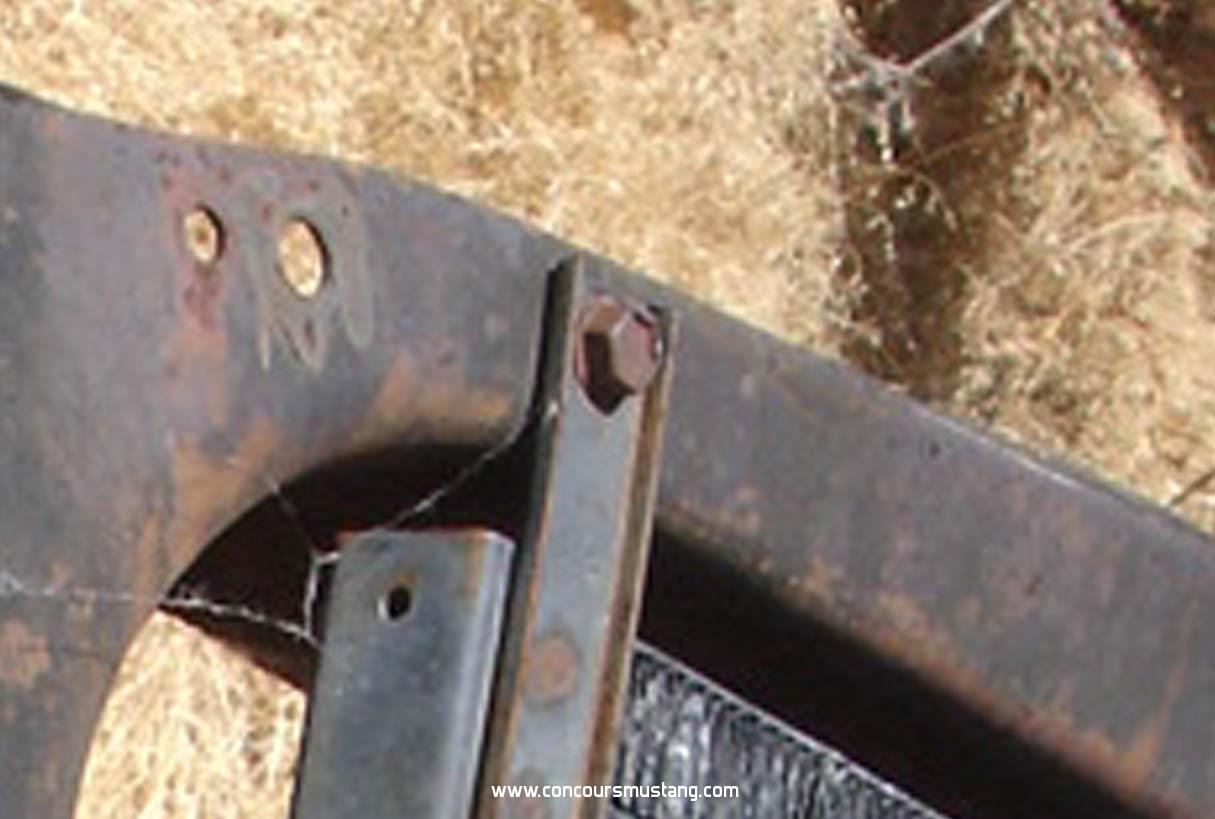

A/C condenser mounting strap hole

Yes....the "extra" hole...is actually always there.  This is for the condenser on cars that were equipped with air conditioning.  I have some pictures in the article that show that being used with the condenser.

Agreed both sides but in the picture Brian posted the hole appears to have been drilled out and the horn moved more towards the passenger side to use that drilled out hole as a locator for the horn - and falls short of that. Just focusing on 69's since that is the picture posted and it eliminates the other difference's with location of the horns
