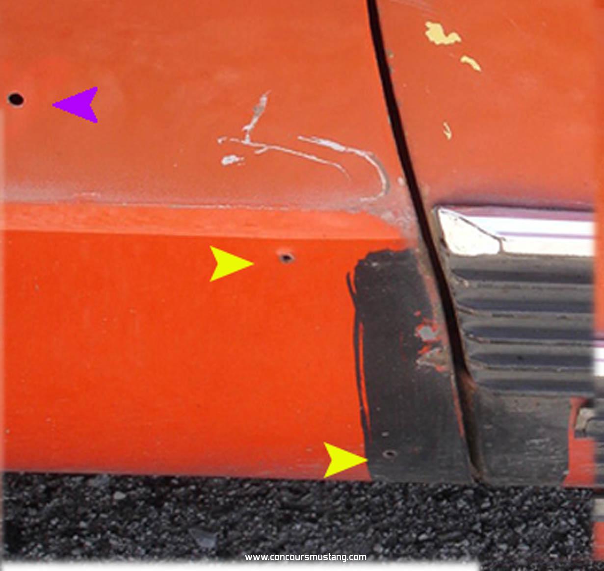

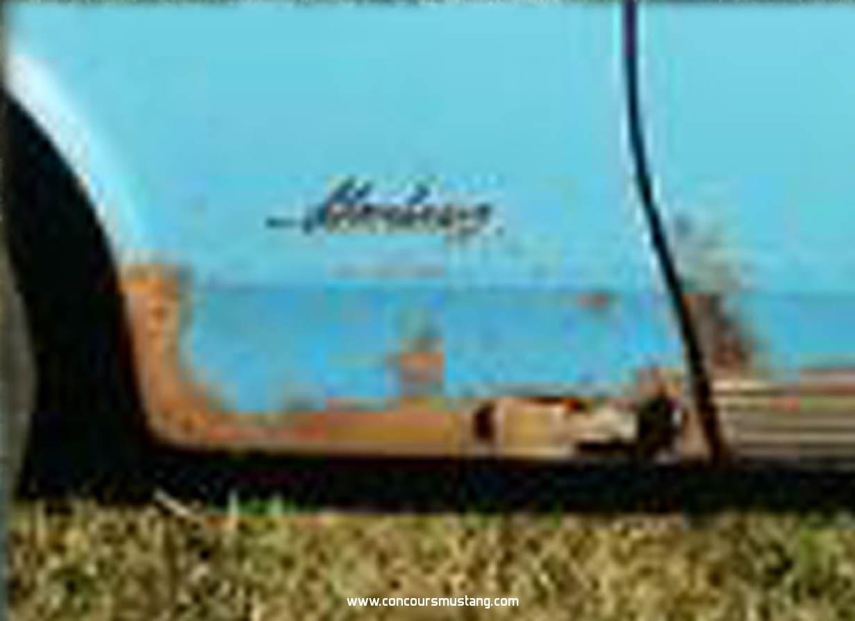

Apparently I don't have a real nice picture of the whole surface with the panel and trim off - can only offer the following in hopes that it will help out some
Looks like possibly 5 holes. If you run out of options I would center the cladding where you want it to end up. Tape the edges so you can relocate it in the exact some spot again. Mark the holes from the back by one of many transfer methods and install

thanks Jeff, just wanted to make sure i wasnt screwing up
